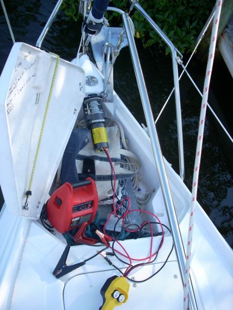

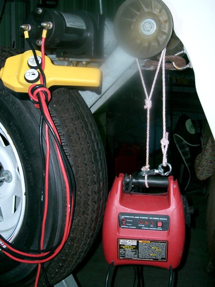

At $350-450 it might be over kill but I understand your issue. I retrieve our 260 with a big 12v winch that came on the trailer that I rebuilt to fit our boat. It's strong enough to pull the bow eye out of the boat. I like power but if it's so powerful that it won't warn you of impending snags or excess friction then it may be too much(think bull in a china shop).
I like buying American when I can but harbor freight has a line of 12v winches with a wired remote that'd do the job just fine(often on sale for $49). I've used one for years to winch on my old 240 and now step the mast on my 260 with one. I powered both with a versatile small portable jumpstart pack that'll easily do 3-4 retrievals, I then just stow the batt pack on the boat in case of emergency.
If it's a particularly steep/shallow ramp then clip a snatch block on the bow and do a 2-to-1 pull but be aware that there isn't anything substantial behind that bow eye unless you've added material like I had to.
