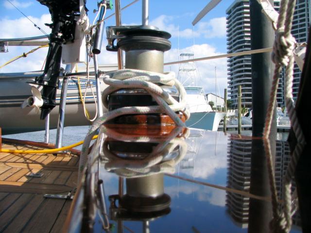

Ditto on the Makita 9227C ... the slower speed is also superb for buffing varnish and acrylic/urethane boat 'brightwork' finishes, etc.
