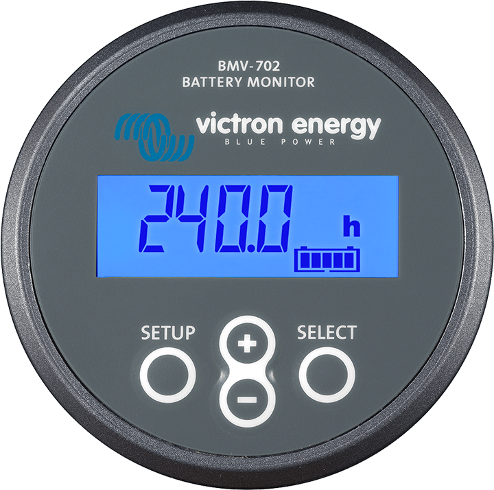

Now having a SG200 Balmar or a Victron BVM702 battery monitor makes sense. Their essential function is to calculate ampere hours consumed and the state of charge of a battery.You are getting new data on the battery health on a constant bases. I would definitely explore their inclusion on the system.

Have you tried to read the numbers on a Victron Battery Monitor? Those Blue Sea digital gauges have nice large numbers so old guys can read them without having to squint or find their readers. :biggrin:

Mine lights up and makes the numbers easy too read. The challenge is in knowing what the coded messages are telling me.:biggrin:
I need a cheat sheet.... You can always use your phone to take a picture and blow it up.
