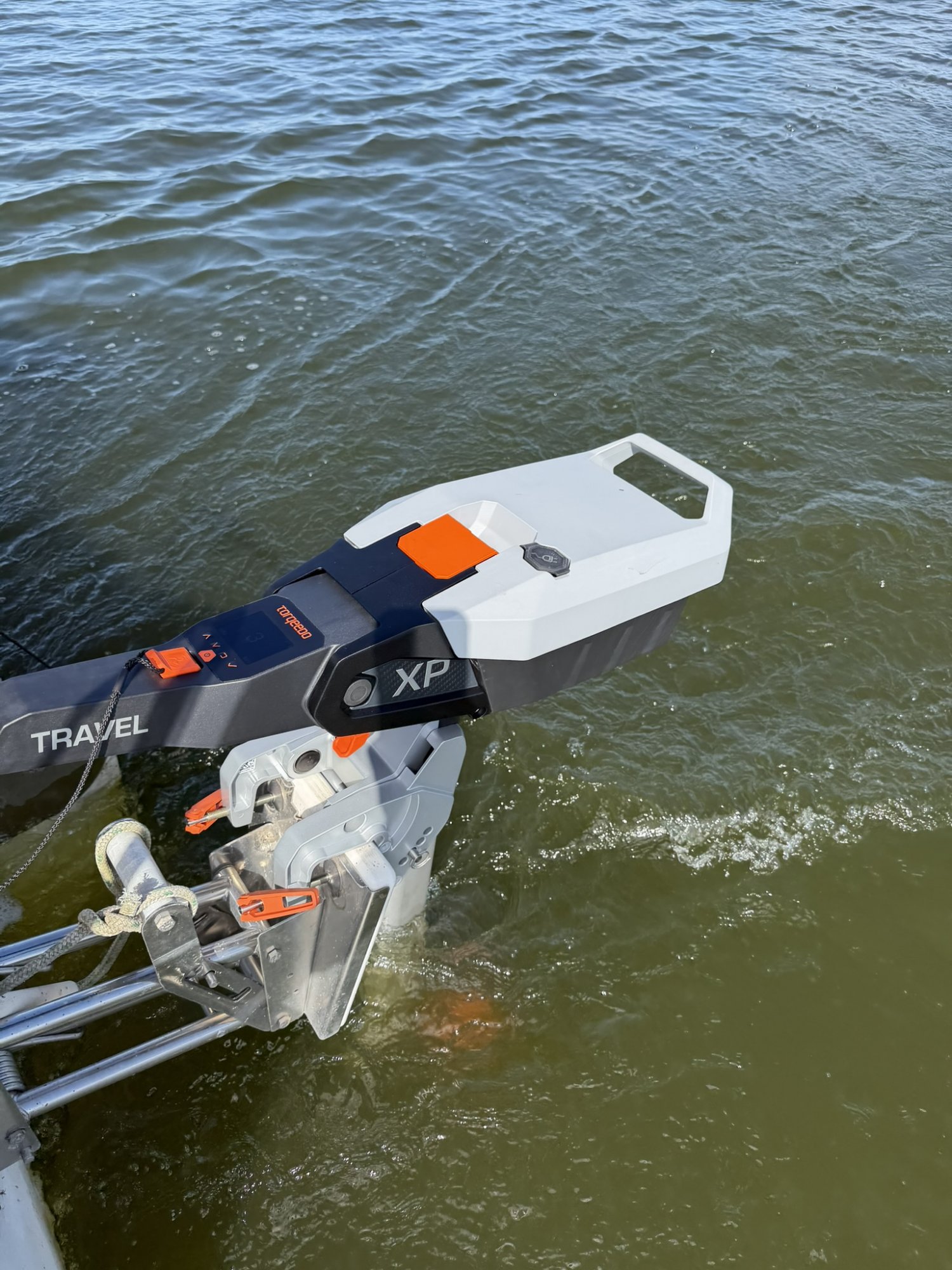

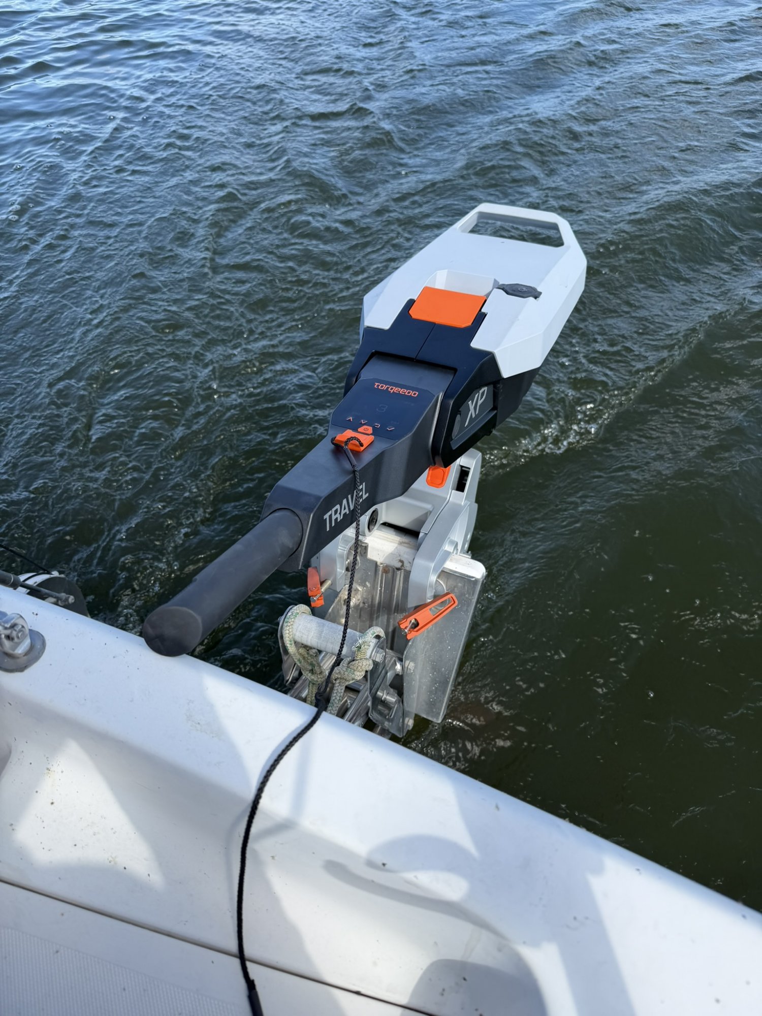

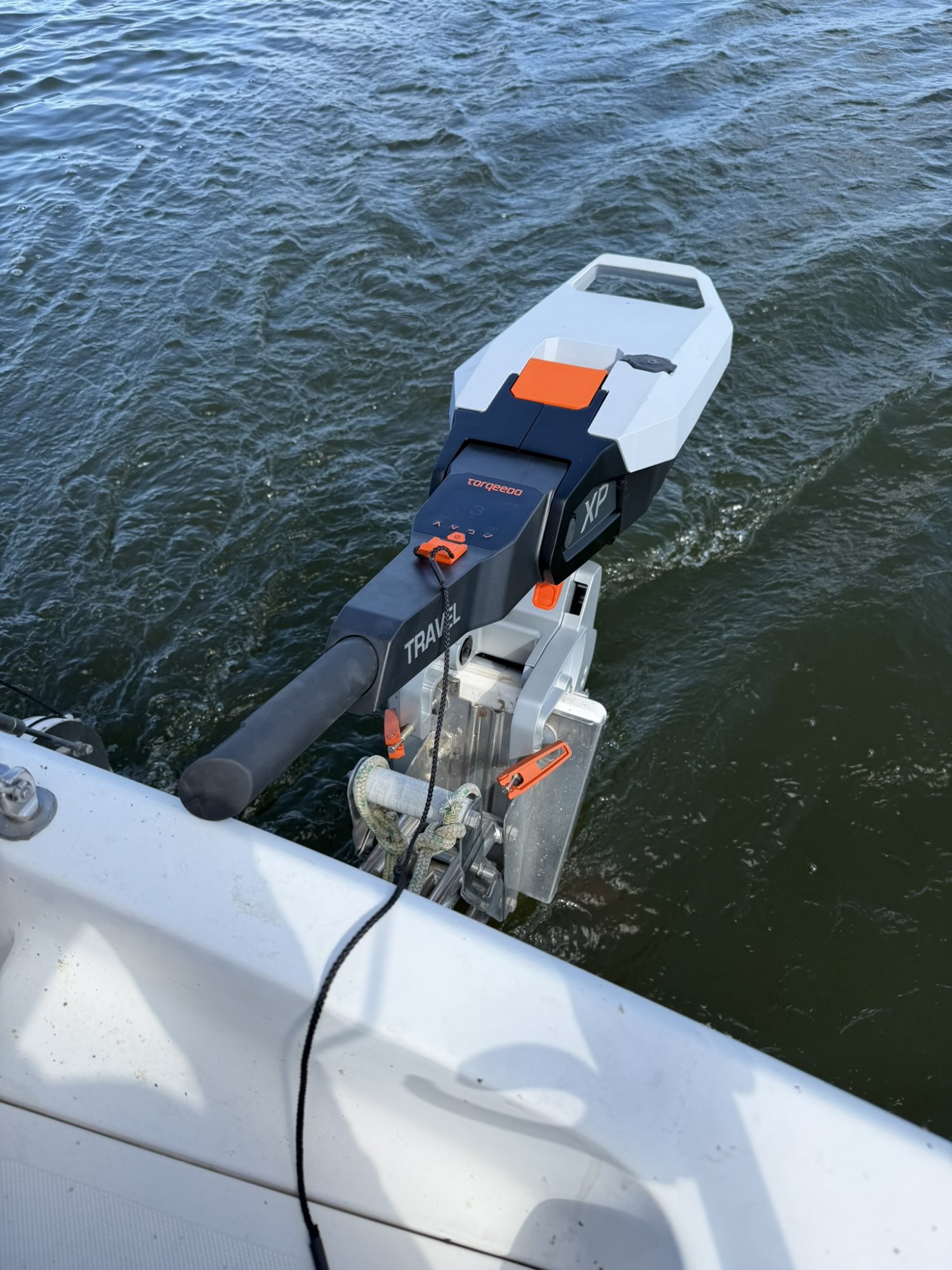

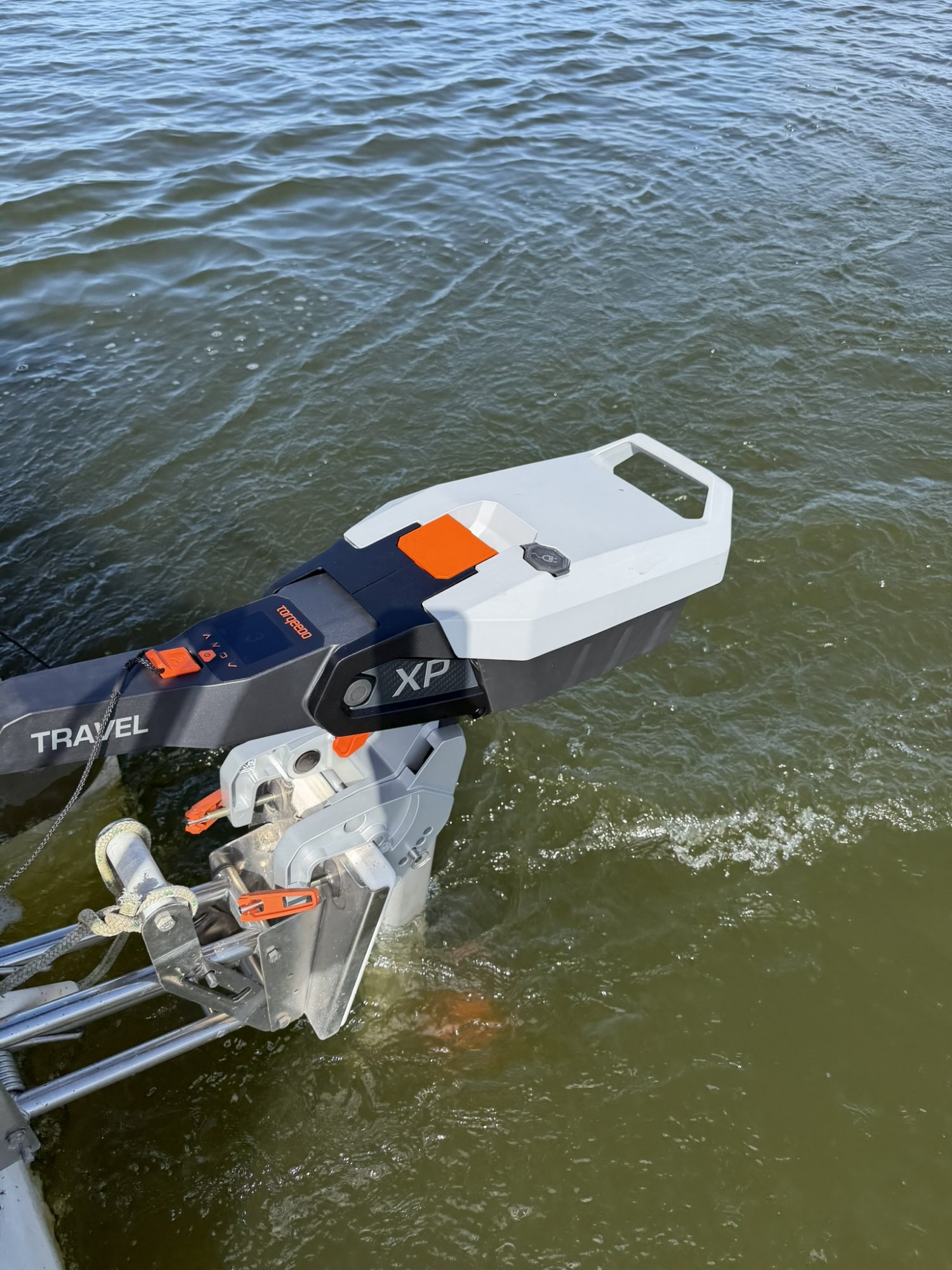

Fred,
I wanted to give an update on my quest for an electric outboard for a Cat 22. I recently purchased the Torqeedo Travel XP and have found that it will push a Cat 22 with no issues at all. As mentioned previously, I lake sail and thus only deal with minimal to no water current. I totally agree with your advice of slowing down to preserve battery and increase range and have found that I can motor away from the marina to the location where I typically hoist the sails and have ample battery remaining for the return. It's also fun to leave the marina 'quietly' while turning heads of people wondering "Where's the engine noise?" :waycool:
If anyone is thinking about making the jump to an electric outboard for your Cat 22...go for it!
