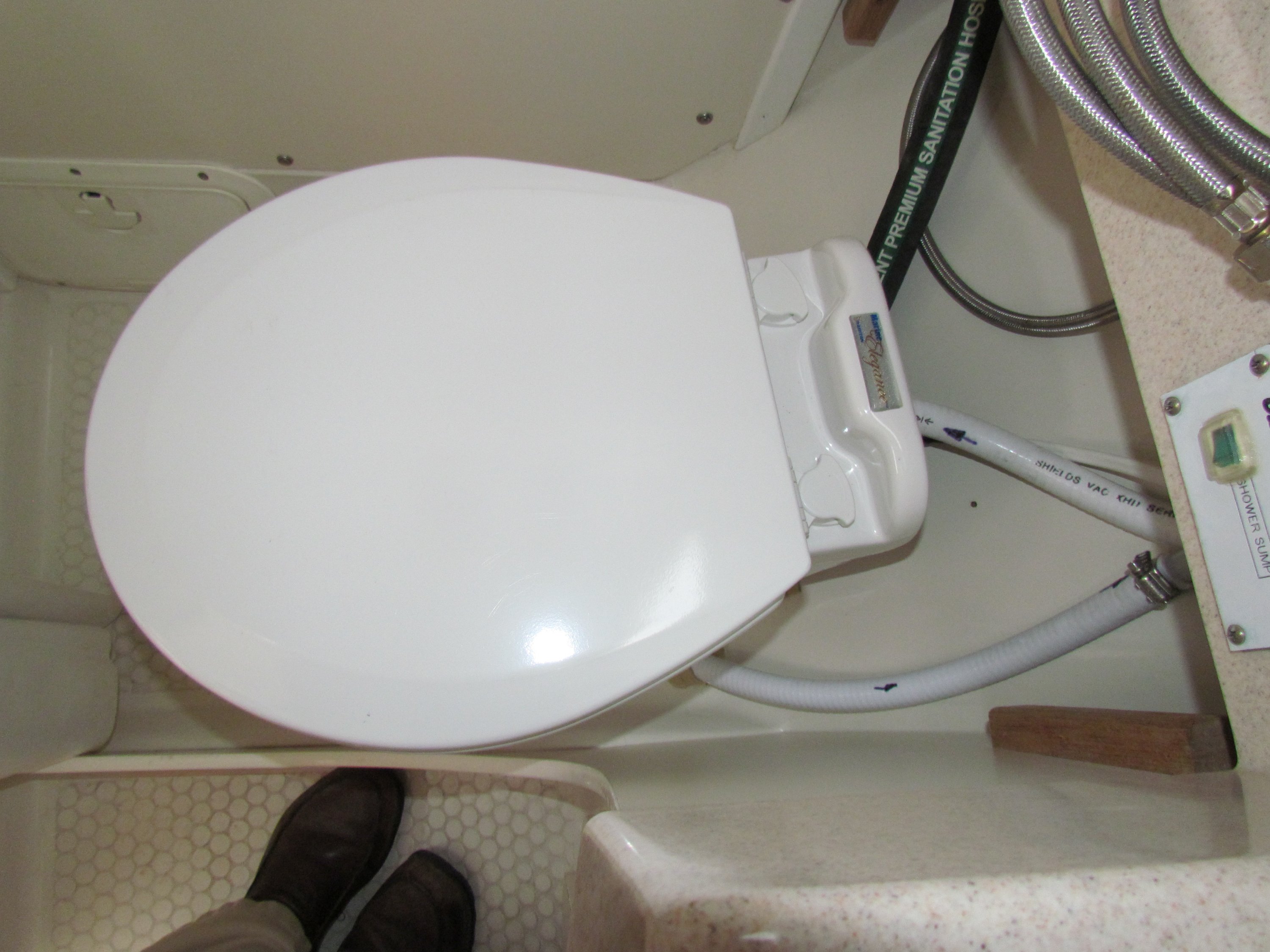

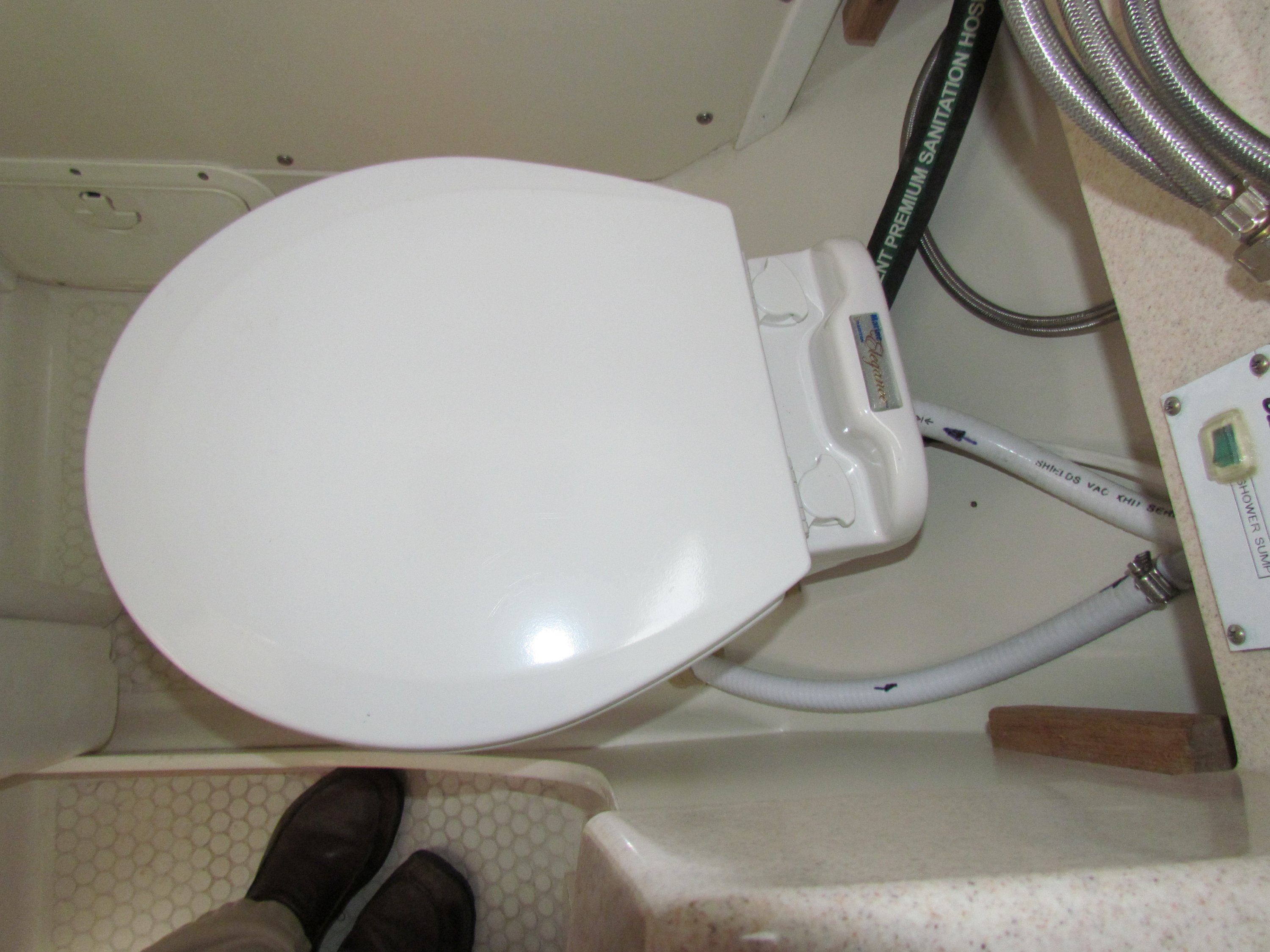

I added the Sea Era conversion and did run it's owner circuit breaker and I did use the old bowl and was really easy install for sure.
We love it for sure.
