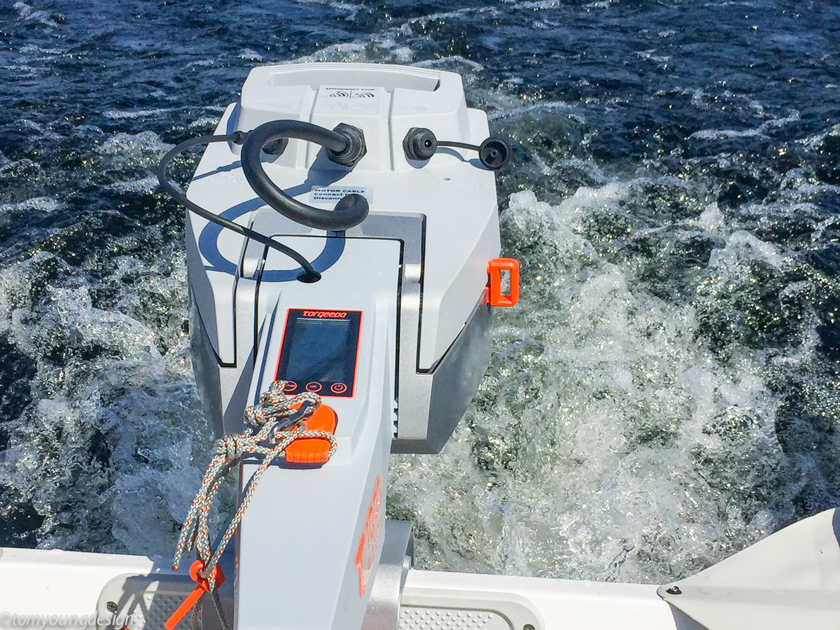

Torqueedo test drive: I've never touched one and there were no instructions in the bag so I didn't know what to expect.

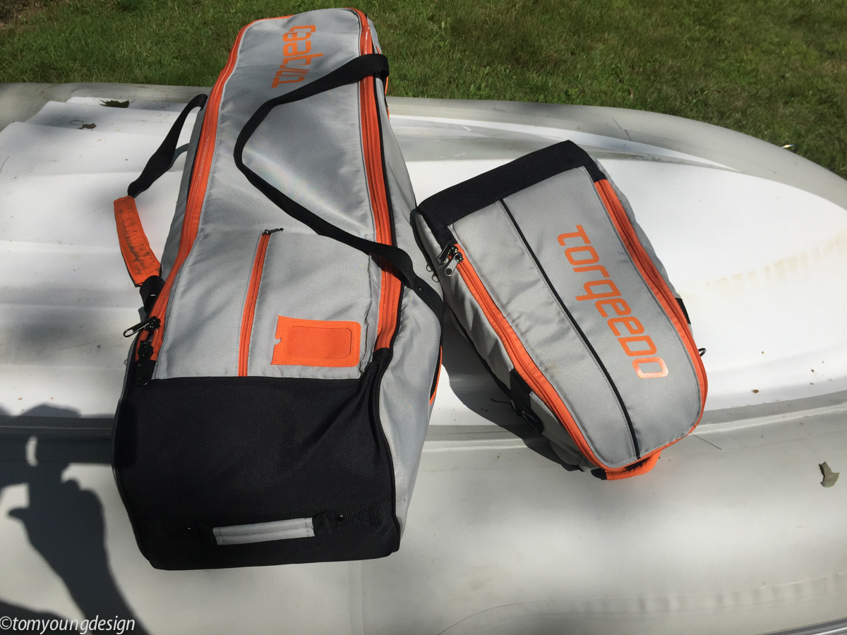

It's an easily managed package though and the bags are well made. The engine bag is about the size of a tennis racket bag but weighs more. The battery bag is quite small and not as heavy as I expected.
I flopped the West Marine 260(or something) into the water. I was amazed at the weight capacity on the transom. Over a 1,000 pounds. But I couldn't, unless you were hauling bricks, how you get the weight in. With two people in it I couldn't imagine much room for gear. But it is a nice small RIB for 2 people and a little gear. But sorry, this is about the Torqueedo.
With no instructions (I'm sure they're online but I didn't have time) I went at it blind. The motor is nicely buckled in the case. Solid piece, heavier than I expected, it's still a very light engine to lift and put on the transom from the dock.
Next the handle piece is very intuitive, the big joints obvious and easy to lock. The batter next, same thing after I realized there was pin that had to be pulled. Pin back in - check.
It clearly states to connect engine cable first / last.
Then I was stumped! How do you turn it on? I assumed the plastic piece on a lanyard was the key, but there was another red piece that looked like it went in something. Clearly I was showing my lack of tech evolution (I still drive vehicles with crank up windows,...).
So phone google, PDF, in German,...arggg, scroll scroll scroll. There it is, simple the key is a magnet and the symbol is right on the housing. Click, it sticks and that's all you do. I gave the throttle a little twist and sure enough, thrust.

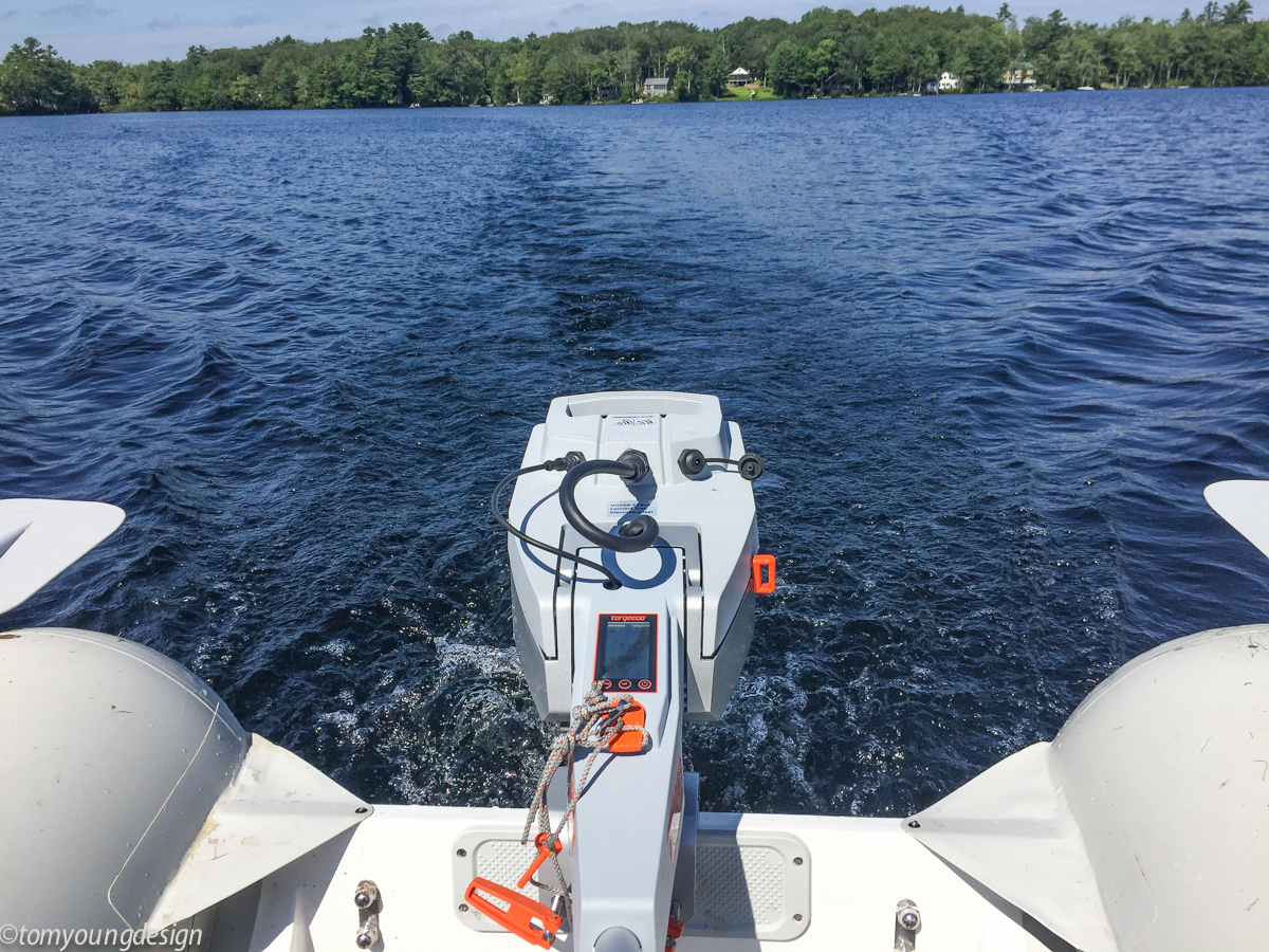

Thrust it's got. The chubby little RIB feels like it's being pushed by more than 2 or 3 HP motor. With me alone sitting on the one thwart in the RIB, the little screen was showing 5mph. If Leaned forward a bit it went up to 5.3,5.4 mph. Clearly not planing but impressive power to me.
It made alittle more noise than I expected but after throttling back, I realized it was mostly the ruckus of the wake and RIB. You could have a normal conversation at full throttle.
More at a 'cruise' speed, 3.5 mph it's very quiet and was pleasant to cruise around the small pond it's on. I snuck up on a loon and her chick. I was quite close and they still didn't dive. But I peeled off and left them alone.
I'm impressed with how well it seems to be designed and built. The meter was telling me state of charge, even watts used. With that it doesn't take long for any user of EV gear to conserve their energy.
All in all, this is a nice compact dinghy motor. Easy package to carry along with gear for many coastal sailors that drive to their boat for a few days of sailing.

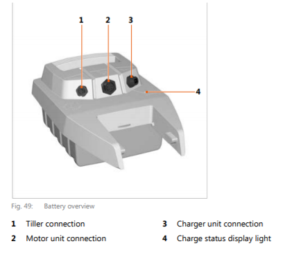

@TomY , is that thick cable the battery connection? What's the port with the cap off on the port side?
I would have thought they'd have devise some kind of contacts like the cordless power tools rather than a cable.

Li-ion battery. The small electrical port is the charger which is a standard 120AC charger.
Thanks,
jv
Yes and the port small is the charger connection (which I see has a waterproof cap which should be installed.)

What's a "standard 120AC charger?" You mean the AC charger supplied by Torqeedo?
