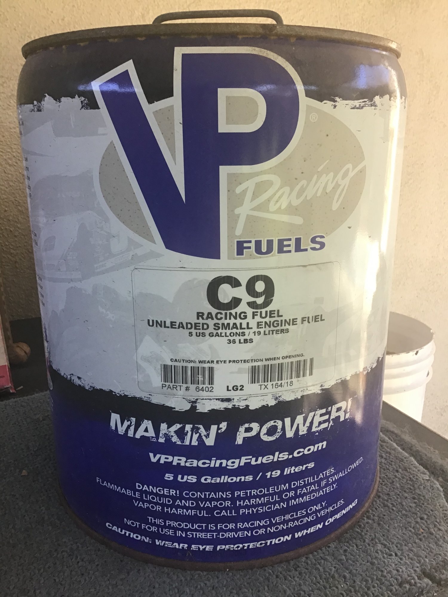

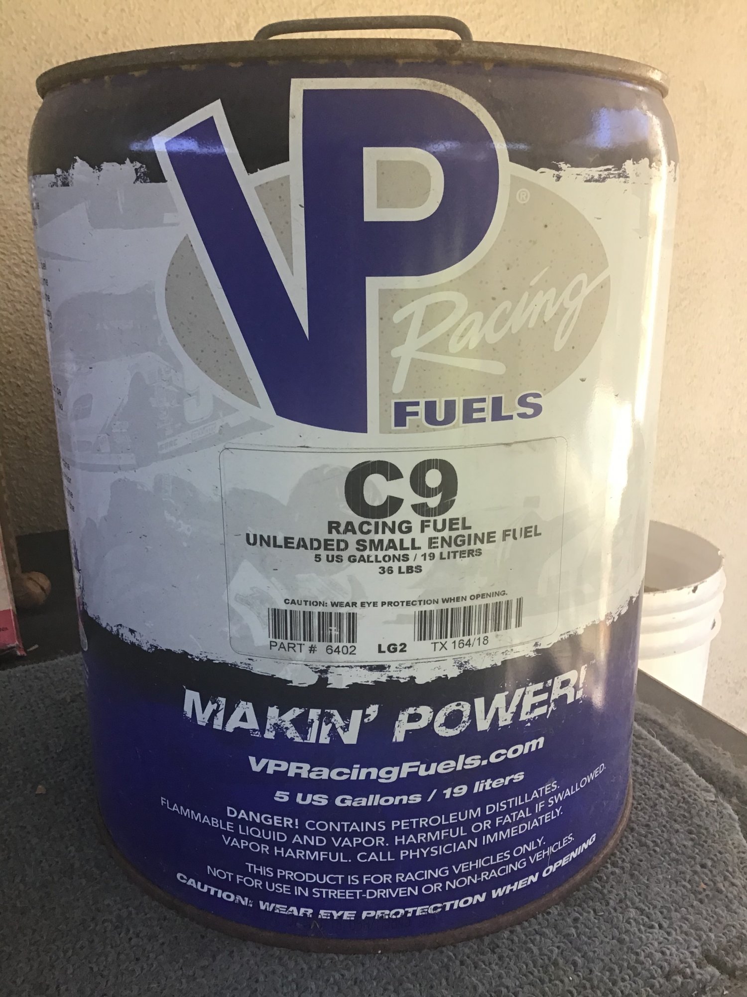

Use formula gas; stores well. Indefinitely. Small engine unleaded fuel; EtOH free. It’s made my life easier w.r.t. outboards. Can buy a lot of this stuff for the price of an electric.
