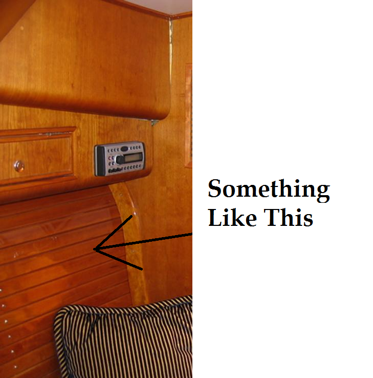

Something that has not come up on this tread is insulation. An adhesive spray foam insulation on the surfaces that are causing you the most problem would work (probably look real bad). I once read an article in Good Old Boat where a guy glued thin furring strips to the hull about 6" apart. Then laid some insulation sheets between the strips and then ran cedar strips perpendicular across the furring strips. Gave the interior of the boat this beautiful cedar strip wain's coat and insulated his hull at the same time. In the article I read, the guy put about a centimeter gap between the cedar strips and they made a point of remembering to pain the insulation sheets brown so the pink does not show through the gaps. I think a nice adhesive spray foam insulation between the furring strips would also work.
I found a pic on the web of something similar. The screws in the longitudinal strips would go into the furring strips glued to the hull and the insulation would be underneath between the furring strips. It would look great and help you control the temperature in your boat.
