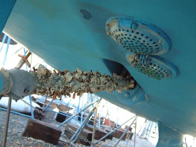

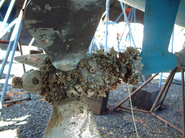

With respect to this Pettit paint, prior to using it, upon pulling the boat at the end of the season, we would find varying amount of growth and barnacles ranging from moderate to heavy.
After our first season with the zinc coat paint, there was no growth... none! and one small barnacle on the shaft adjacent to a shaft zinc which I attribute to my sloppy tape job in which I tried to cover the shaft zincs prior to spraying the paint and overlapped the tape slightly onto the shaft.
I would be interested to hear others' opinions as to whether I was just lucky or is this stuff really as good as it appears to me.
