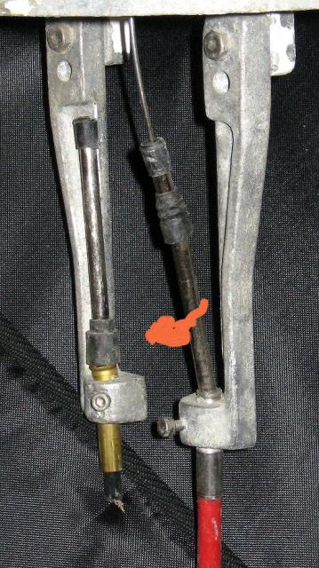

All are correct. It is a Merriman. Fior some reason the Fuel Leg [Y321-0091] was removed or never installed. This probably won't be clear, but I'll try to explain. The cable clamp did not loosen. As a result of the absence of the leg and lack of lubrication, the outter section of the cable just above the clamp parted [I'm not sure how they are held together. Are they crimped?]. Instead of the inner cable slidiing inside the cable jacket, the section above the clamp would move. Since the inner cable was not stiff enough to overcome the resistance from lack of lubrication, and the outer sections had come apart, the inner cable just bent when the lever was pushed where it had no jacket to provide stiffness.

Here's a picture of the fuel legs. The leg/cable on the right controls the transmission. The leg/cable on the left controls the throttle. This is not a picture of my cable. The red arrow indicates some kind of fiitting (?) that holds the upper tube and lower tube together. Mine does not have that fitting, or it broke off. This allows the upper tube to separate from the lower tube held in place by the leg. When the throttle lever is pressed, the inner cable AND the upper tube elevate, exposing the inner cable at the arrow. When you try to return the throttle, the inner cable does not return into the lower tube, it just bends. Any ideas on how to make a replacement for the fitting or make sure the lower and upper tubes stay together so only the inner cable moves? Replacing the cable is, of course, a reliable allbeit ugly option.

Richard: Just read your post from the 23rd..My Hunter 31 1984 has only the shift leg in the pedestal. The new cable has a long stainless steel shaft that once the cable is locked in the pedestal clamp stays nice and rigid with no binding. Until I read your post I did not know what the leg on the shift lever was. If you take off all of the add on sections under the compass you can get a good shot at the clamp with PT Blaster. That did the trick for me.

So I wonder if Hunter or Merriman did away with the throttle leg and substituted the clamp arrangement instead? The Merriman manual says the throttle leg is only used with the forward moving throttle lever. Yet the leg is used on the shift cable, which is both forward and backward. Oh well, since I now have a throttle leg, I will probably use both clamp and leg
