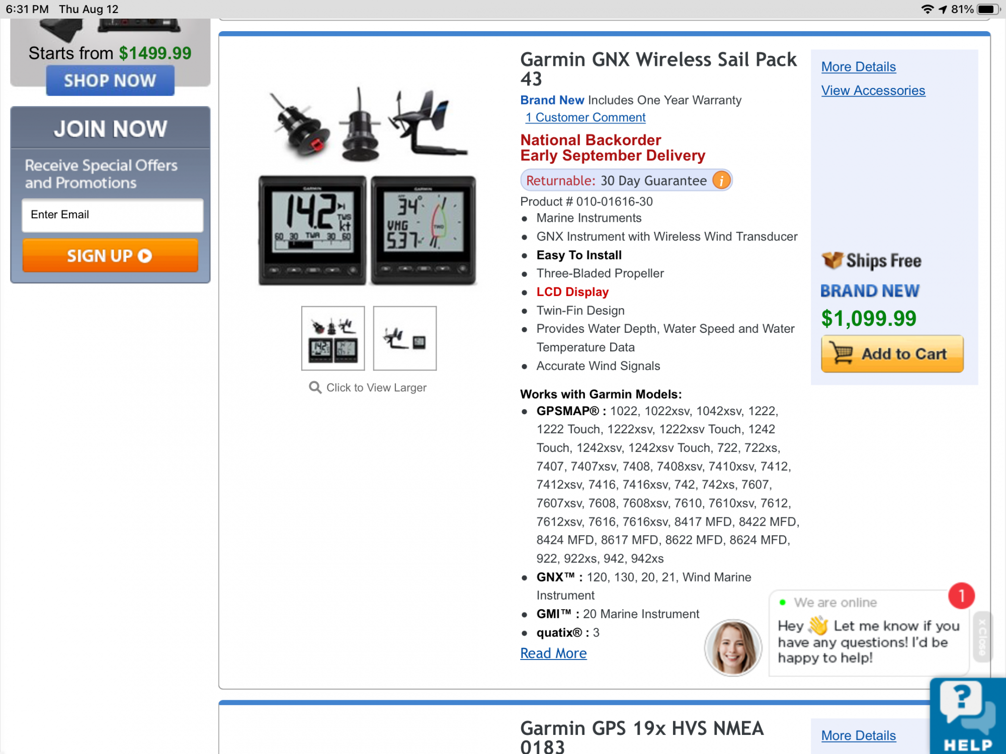

Hunter 26.5 owner looking for advice on economical package of instruments that don't cost 1/3 of the boat value. I would like wind speed, depth and boat speed.

There are 3 main choices, Raymarine, B & G, and Garmin. Raymarine tends to be less expensive, B&G more fully featured. Keep an eye out for sales. Defender has a big sale in late March and the prices will be somewhat better, but still in the 4 figure range.
These systems all use NMEA 2000 which allows for easy system expansion. You may also be able to find some items from HummingBird or Lowrance, but these probably don't have wind data.
