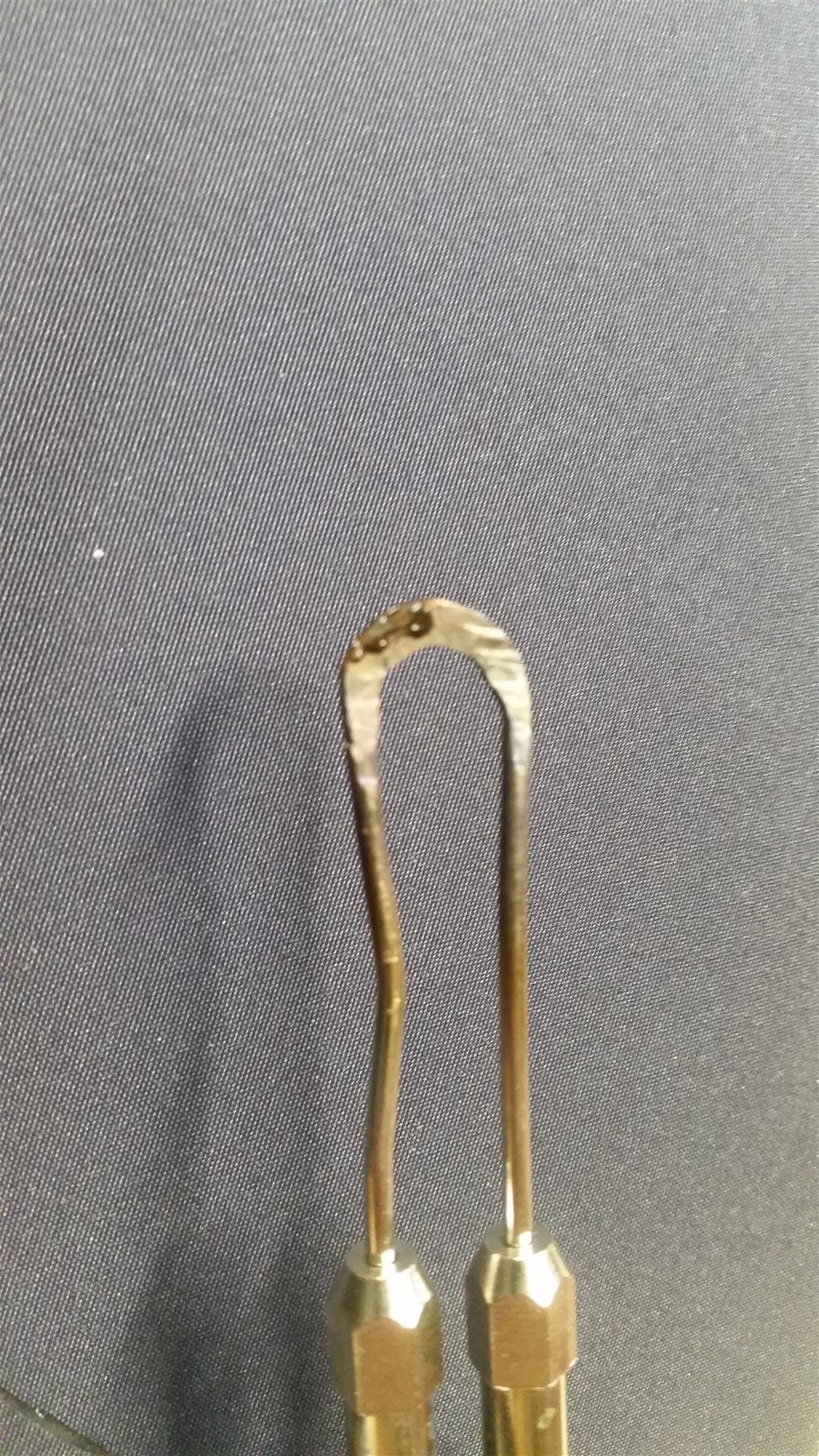

I have been busy sewing a pop top tent for our Hunter 20 and was in need of a hot knife to cut the fabric with to keep the edges from unraveling. I don't do enough to justify paying 120 for a official hot knife so after trying a few of the single element soldering iron type knives with disappointing results I decided to make my own.
I started out with a dual element soldering iron from Harbor Freight for 13.88 on sale. I then took the spare tip that was a constant diameter piece of wire and reshaped the end to for a curve about the diameter of a dime. I then took it to the anvil and hammered the curved part of the tip into a flat knife shape. You don't want the edge to be "sharp" as it will cut through the material without transferring enough heat to seal the material. You want a nice smooth rounded edge on the curved part. I filed the new edge smooth and cut the element legs to an equal length and installed the new tip in the gun.
I squeezed the trigger and gave it a try and it worked better than I even hopped it would. It seals the edges perfectly and only takes about 25 seconds to heat up. The built in light is a nice touch as well.
Here is the tip after I formed it. I had been cutting quite a bit before I took this pic and it seems to be holding up well. I think it will serve my needs very well.

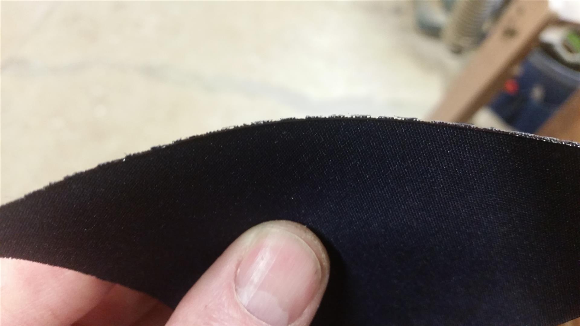

Here is a sealed edge of material after cutting.
It is common for some of the sealed edge to stick back to the to other side as you are cutting. I thought that was a problem till I watched a few videos and saw that was common even on the expensive hot knives. It cuts easily if it does not separate when you pull the pieces apart.

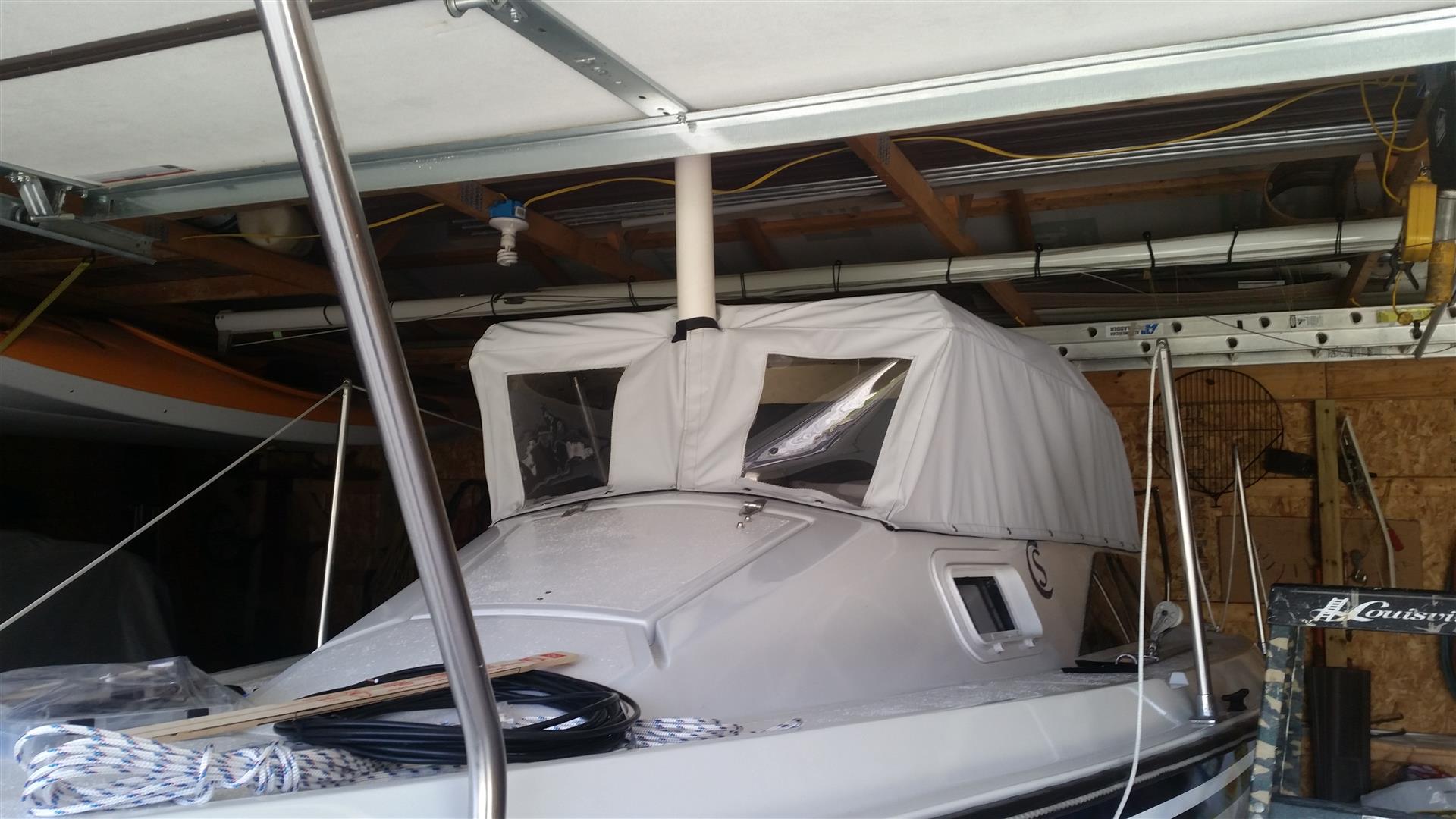

Here is our top now that it is almost done.

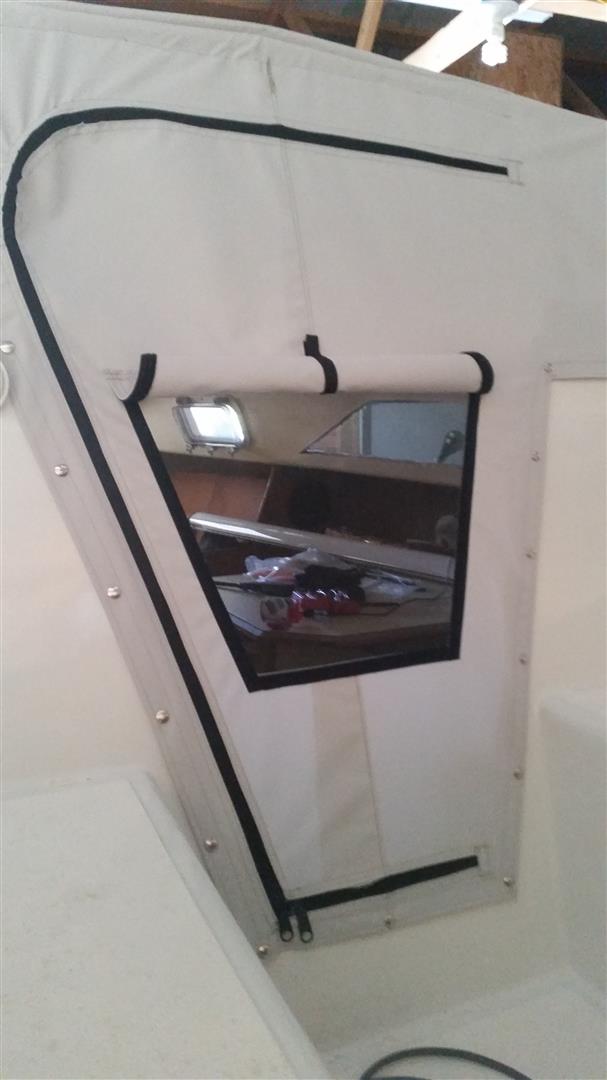

The dark area below the screened opening is a overlapping edge inside that I need to trim yet. The light was shining through the windows in the front which made that show up. This project really pushed the limits of not only my sewing ability but also the limits of my old machine. This was the first zipper I had ever put in and the curve turned out to be a real bear. But that paled in comparison to the problems the window material gave me. It was absolutely awful to sew till I figured out that it was sticking to the table and then the bottom of the presser foot of my machine. Once I coated both surfaces with painters tape it went much, much better.
Wish it had turned out better but it will serve the purpose nicely.
