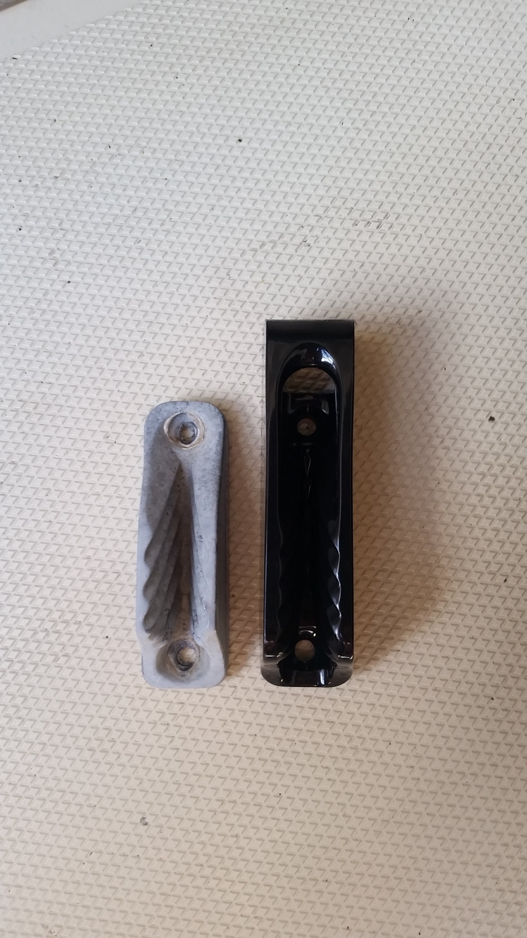

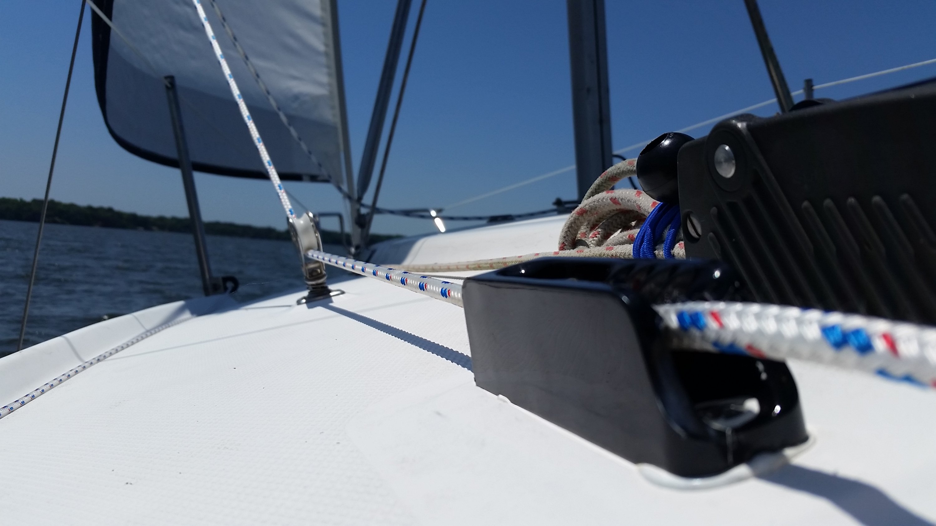

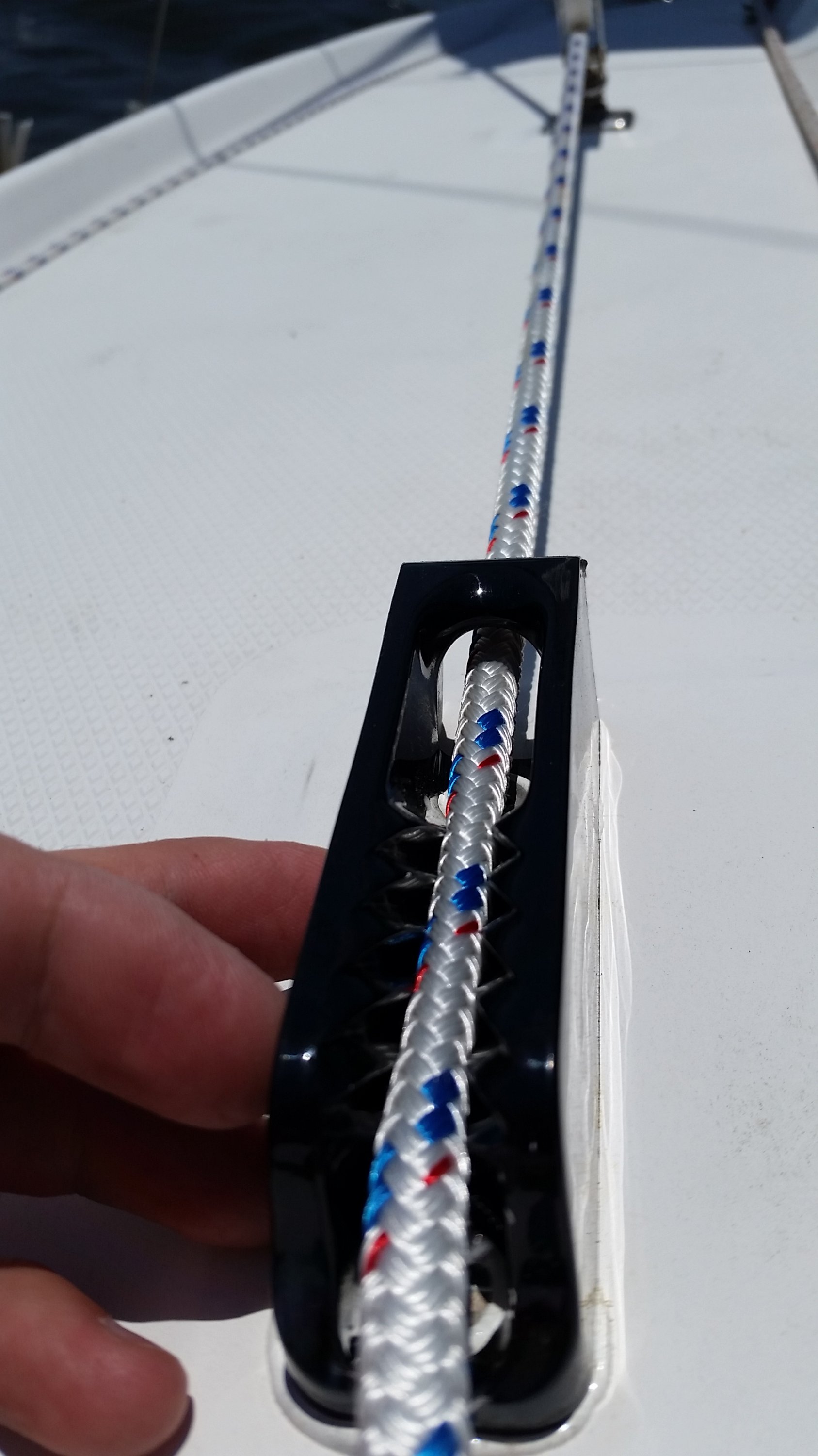

I have seen several remedies to the jib sheet cleat issue on the 240. I finally found a cheap and easy resolution to the problem. Clamcleat part # CL228. I did some research and the holes match up perfectly. This is a jamcleat with a farlead that maintains the correct angle of the Jib Sheet in the cleat unlike the stock one that pulls itself free whilst sailing. Just thought I would share it with people before they go cutting Teak wood for risers or drilling holes for cam cleats. Hope this helps someone else. This website has been a great help to me. Just trying to give back a little. Installation PDF
