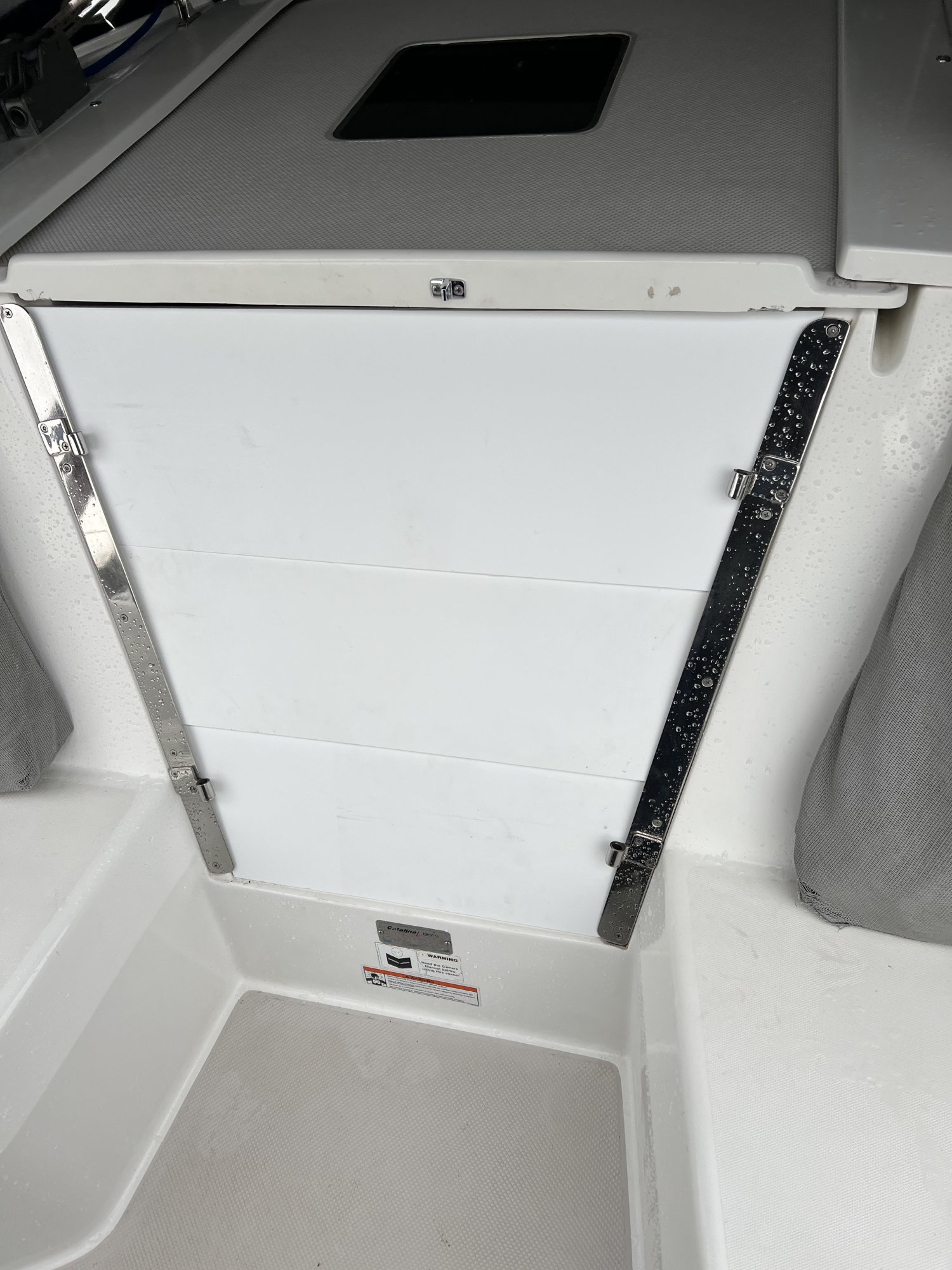

I replaced the wood boards on my First 310 with Seaboard. Cut on an angle at the bottom (mid-section) so they mate nicely and prevent water intrusion. Seam is not very visible. Cutting was done with a table saw, jig saw and router. Used the old boards as a template. Worst part was getting the top curved dimension correct. Took a redo for the top piece but had enough material to accomplish that. Had to redo the top piece because I had not allowed for the loss of height resulting from the overlap created by the 45 degree cut at the mid-section - measure twice, think about it! then cut! My track that the boards slide into is 3/4". Did the math after consult with US Plastics tech people and decided to rout the edge of the material that slides into the track slightly to make it less than 3/4" to allow for some thermal expansion.
I got the material from US Plastics. Mine was 3/4" X 24" X48" Polar White Seaboard UV Stabilized HDPE Sheet, P/N 46056. Cost in 2020 was $97.38. US Plastics was the supplier, VYCOM is the manufacturer of the material.
I also have the Zarcor doors which you can see the brackets so I can use them when I don't want the full boards in place.
Hope that helps.

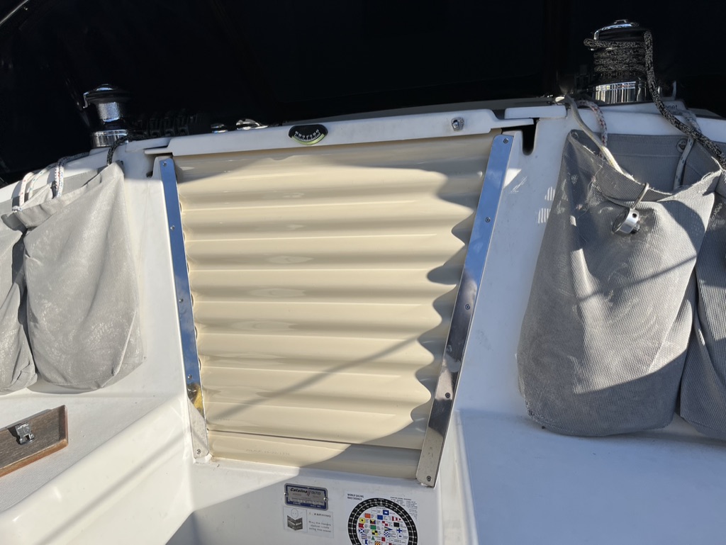

I went super simple: Home Depot - used a sheet of corrugated roofing sheet. Cheap. Strong and light. The corrugation takes up the thickness of the companionway channel. Cut it with shears.

Even better in some ways because the hatch boards have four or five teak sections that potentially allow water in, whereas the roofing sheet has a one piece construction. By the way, you can use two sheets overlapped - that's what I do sometimes to add stiffness. The corrugation allows different position options as the two layers can lock together. The sheets can also be rolled and stored away, if need be.

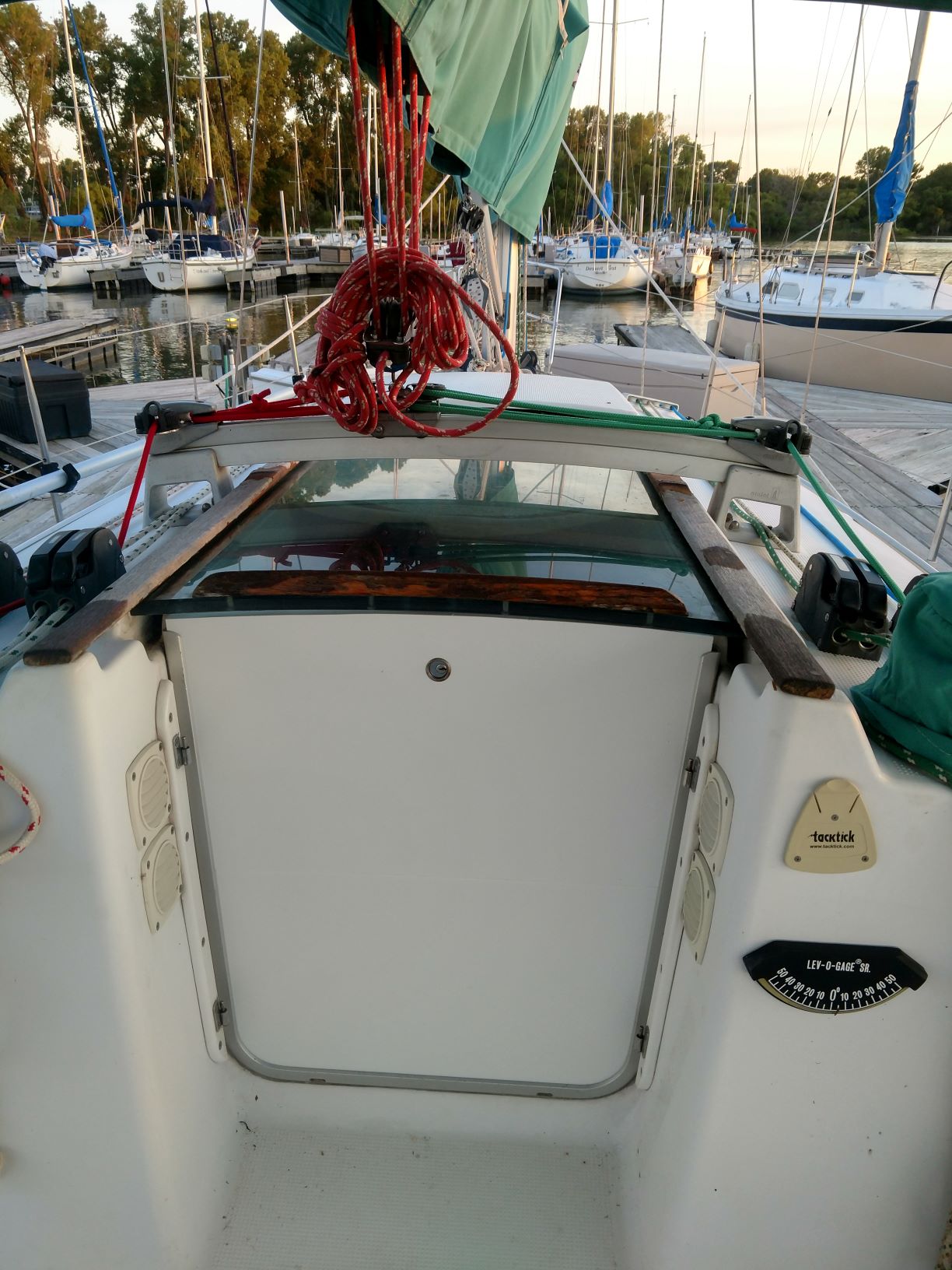

My previous boat had acrylic (Plexiglass) hatch boards. I liked the look, they were smoked grey so had some privacy but allowed light through. Plexiglass is stronger than King Starboard and comparable to plywood. It is easy to work using woodworking tools. Probably more expensive than plywood, but might be cheaper than Starboard.
The hatch boards on that boat were in two pieces, there was a strip bonded to the top of the back of the lower board forming the lip.

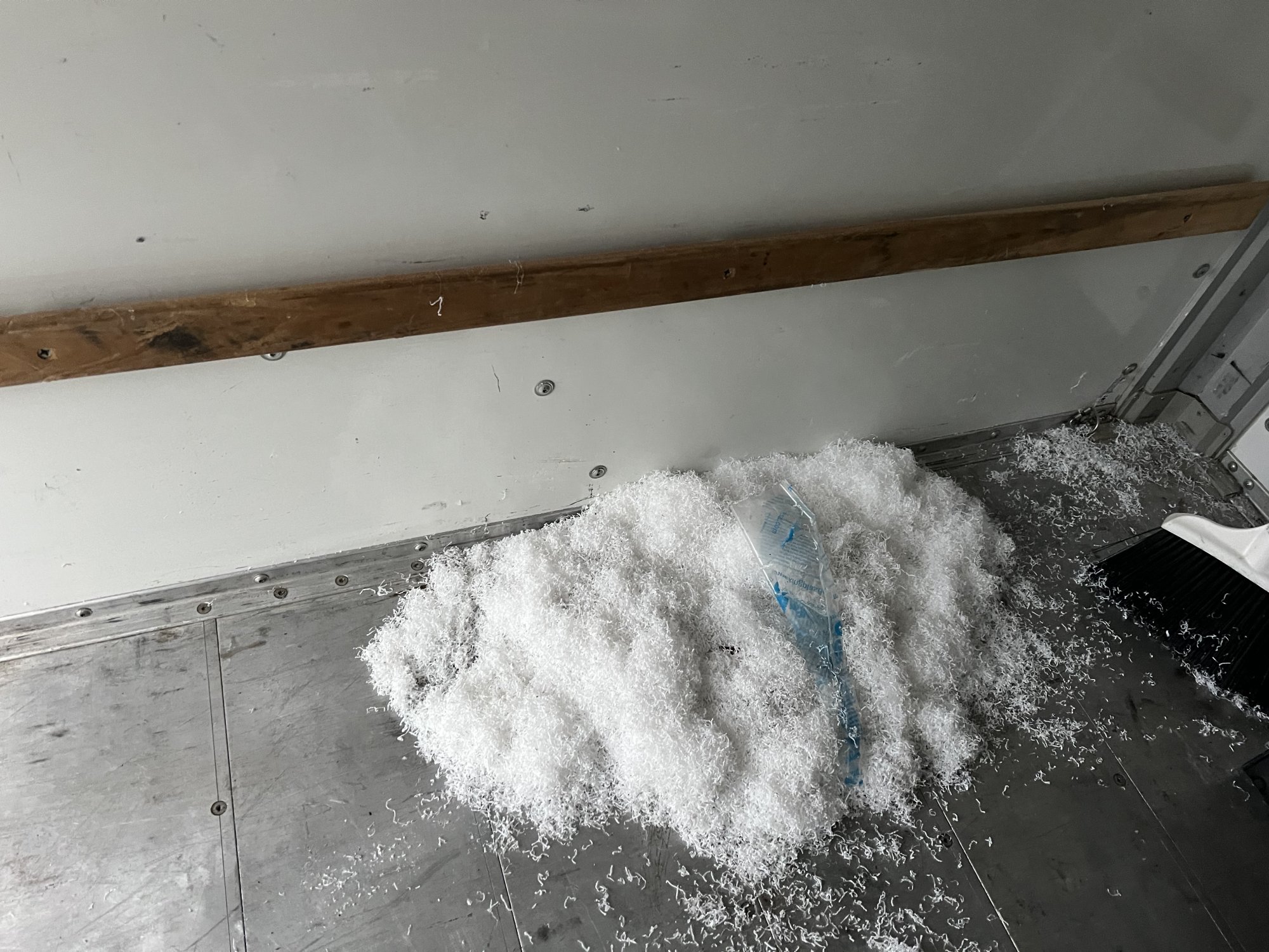

I ended up using King Starboard. It was around $250 for the material from my local TAP Plastics. It cut easily with a miter saw and a table saw. I saw no good way to make a perfect template, so I just used the doors as a rough template and then cut in the boards in the marina parking lot, making lots of trips to the boat to check the fit as I got the cut angle dialed in on the miter saw.
For my use, they came out pretty good and I don't have to mess with any treatment of wood or worry about warping. They are on the heavy side, if I had to guess 50% heavier than teak would have been.
I also noticed that the slot is more like 1" wide, so my 3/4" star board tends to not align perfectly at the angled seams between boards since the boards end up "slouching" in the slot. If I get around to it, I plan to rip a 1/2" wide by 1/4" thick slice of scrap starboard and screw it to each edge so they fit more snug in the slots.
While it cuts and sands very nicely, it sure makes makes a big pile of this stuff:

I can also attest to the pile of stuff! I am very happy with mine and they won't rot! They are clearly heavier than wood products and cost is probably why the boat mfg's go with the wood. After they sell it, to them, it's not a matter how long it might last.
Could make "My Pillow" out of that. :biggrin:
