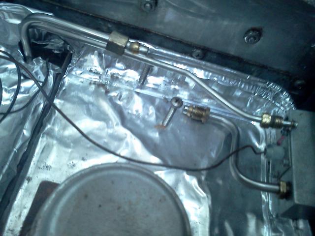

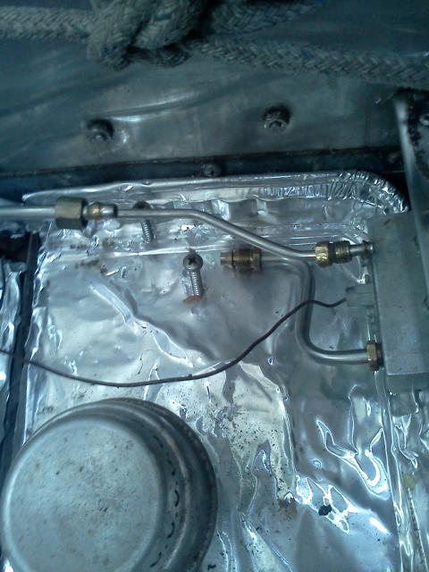

Check out these pictures. When I lifted the pan to look for orifices and stuff I found these pipes detached and apparently a piece missing. You can see two screws going down into the stove that were holding the piece on, two threaded fittings male and female that should have gone into this mystery piece, and another male fitting not connected. These are all going to the oven control, which I never turned on. What is the missing piece and where can I get one? This wouldn't have affected the low burner flames, would it?
Both stove burners have low flames at full power. My Force 10 cabin heater still has a full, strong flame. I have a new solenoid and regulator that was working fine on the old stove. Does that narrow down the burner problem? Sheesh, what a weekend I've had. Add in the check engine light coming on in my car at the top of Snoqualmie Pass four hours from home and the frikken busted bolts on the manifold and it's been quite the adventure last weekend! I'm hoping for three happy endings but my friends say I'm a pie in the sky dreamer.

I would not flip on your solenoid!:doh: If you are in Washington try Sure Marine Services, they are out your way, and they should be able to fix you up. It looks like you're missing your oven control valve.
It will likely be significantly easier and probably safer to just bring them the range and have them repair it and give it the once over..

The problem with these older units is that there were a number of configurations over the years and the parts are slightly different. Without that valve it would be tough to guess which one to replace it with and get everything to line up. With this being propane you want to do it as safely as you can. LPG can accumulate like snow in the bilge until it gets deep enough and goes booom...

Those loose tubes might be for the oven burner. That thin "wire" is probably a thermostat capillary tube.
