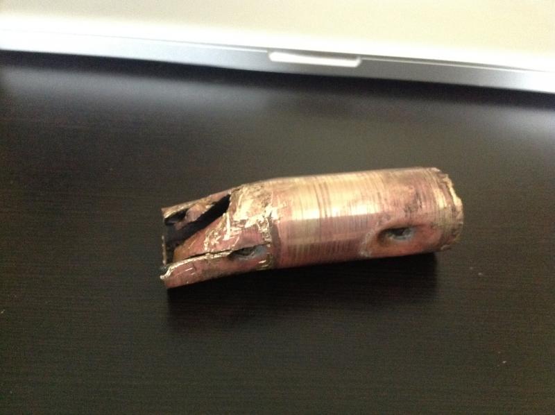

Having the proper tools to begin with, I thought this was going to be a nice one hour job. Murphy Strikes....
Using a tool to remove cutlass with and after two hours of tightening down the damn thing would not move - yes the set screws had been removed. The owner of the tool had to leave and with him the tool. May the fleas of a thousand dogs infest his bed.
So, using Mainesails way of getting it out
http://www.pbase.com/mainecruising/replacing_a_cutlass
With a hack saw and several cuts, in go the two bolts and start turning them. Oh shit, they went through the damn bearing NOW WHAT!!!
When all else fails, get a big hammer and punch and start banging away.. Once it was about half way out, I put a pipe wrench on it and started turning and pulling at the same time. Slowly, with a few more hits out it came...
From the picture, I do believe it is scrap... Lost a little skin, bleed a little but the damn thing is out.. been in there for 7 years......
Now drinking a beer and going in for attitude adjustment therapy...

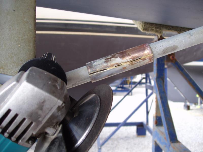

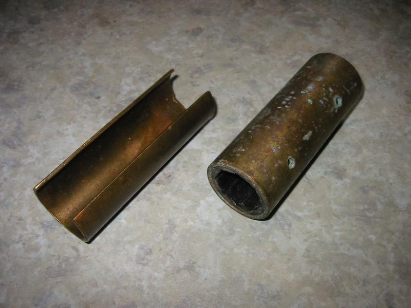

Like you I was very disappointed with the procedure, particularly the need to remove the prop shaft to get the saw blade in.
So, I removed the strut and had my pal bore it out to 1 1/2" so it can now accept the 1" x 1.5" x 4" long cutless. This is a more common standard in older boats. This bearing comes in a 1/8" thick wall bronze tube.
Now all I need to do is remove the prop, slide my old bearing with the 1" section cut away on to the shaft, remove the grub screws on the worn bearing and gently tap it out.
No hassle, no fuss, no need to remove the prop shaft and a genuinely 30 minute job.
Whilst about it I also made stepped grub screws and pop mark the new bearing through the grub screw holes. Then I take it out and drill two 1/8" holes through right through the tube wall so the screws bottom on the outer shell of the bearing and are 'proper' retainers.
See attached pic of the extractor.

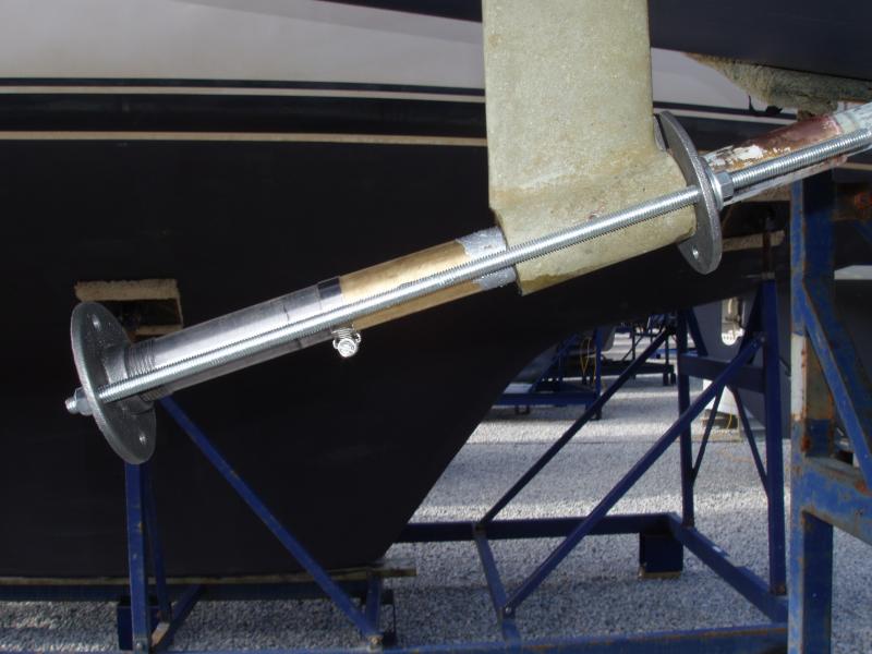

Cutless bearing tool you can make
The design of the commercial tool push the bearing out towards the prop end.
I didn't like it as the tube is in two half and complicated to make.
I made a tool that pushes the bearing inward which is much simpler. There is no need to remove the shaft. Once the old bearing is out of the strut, simply cut a long slit to open it.
The tool consist of a black steel pipe, flanges, screw rods from Home depot (Less than $20). Had to machine down the steel pipe to fit inside the strut.
See picture.
