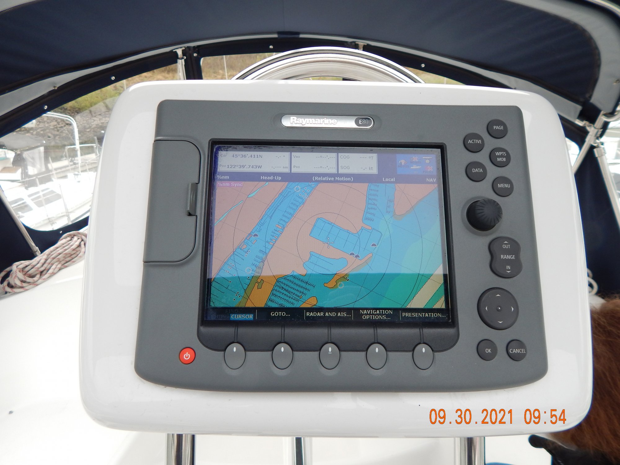

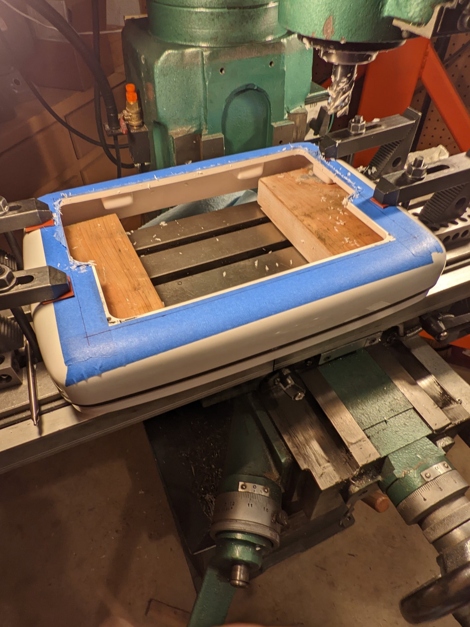

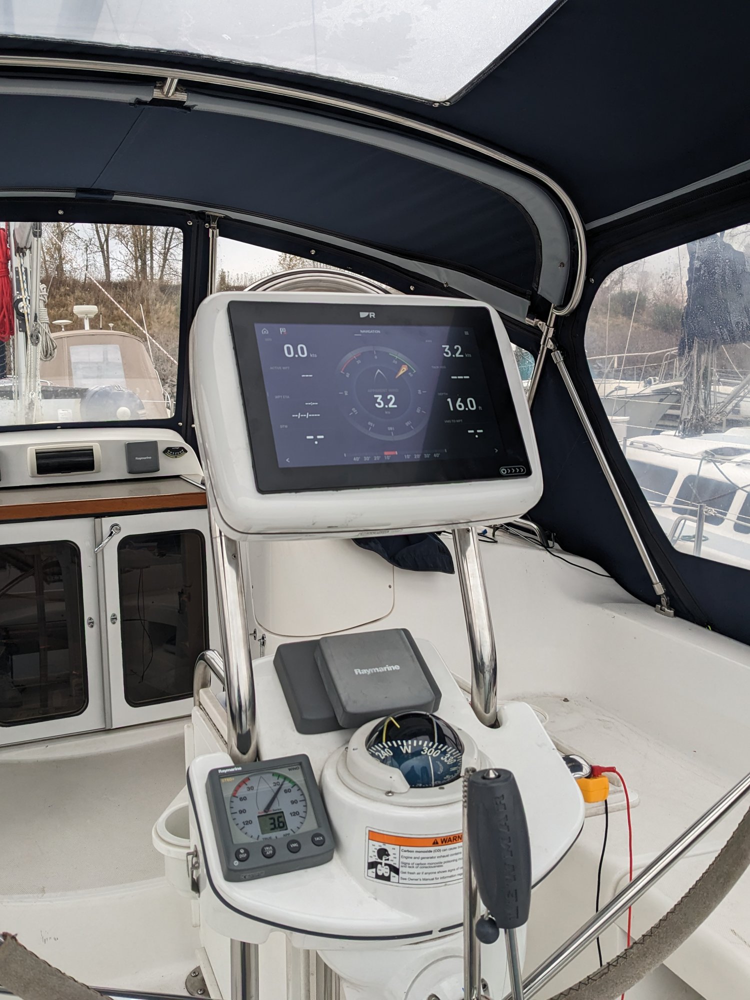

The first photo shows the Axiom+ installed in the NavPod at the helm station. The second photo shows E80 that was present (photo from the pre-purchase survey). The third photo shows how I enlarged the hole in the bezel to accommodate the larger display using my milling machine.
