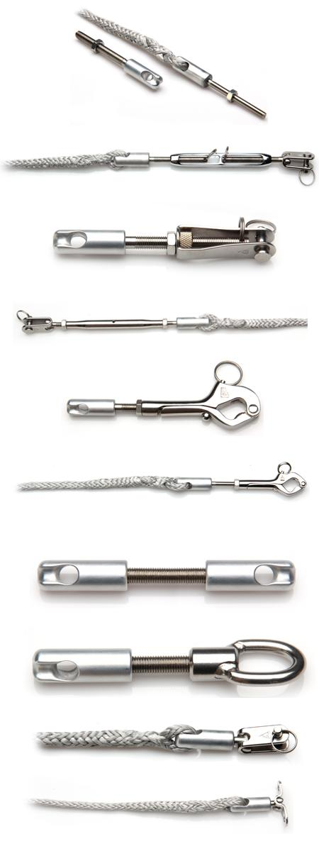

I agree with capt. Larry, a shortened Brummel splice and stitching backup will be plenty strong. I used a fittings
from csjohnson that are designed for lifelines for a gate stop and other attachments.

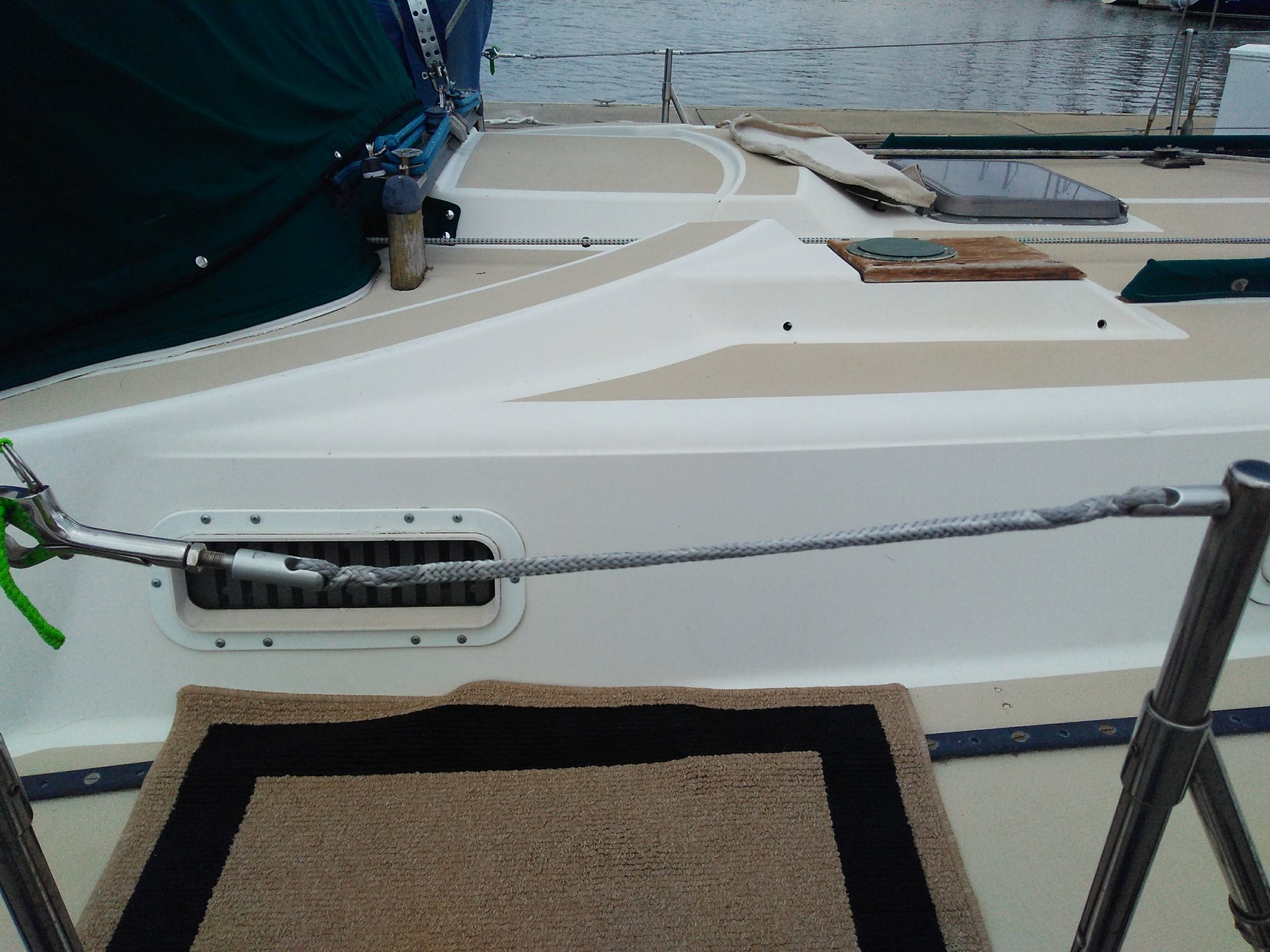

I used pelican gate hook, did buried splices on each end, and lock stitched the buried splice. The buried splice nearly meet in the middle of the gate space. That had to happen to get the needed length for Dyneema. I then tensioned it with the threaded portion of the pelican hook. I have 2 gates on my boat one each - Port and Starboard.
They have been up for 3 years. Still look and feel great. There has been no need to adjust the tension. There is still room if necessary. Getting more dyneema would be a cheap fix when I need to retie. As far as the rest of my lifelines they are stainless cable. Looking great.

yes! this is some of the hardware I'm planning to use, after going down a rabbit hole of looking at gorgeous Colligo hardware, lashings, and more, I fell back to the modest CS Johnson route.
Thanks for your advice!

Ah, so you only replaced your gate. What you describe about your splices meeting almost in the middle is exactly. what's going to happen to me, plus they'll be a tad short. So whipping them sounds best. I'm grateful. Thank you!
