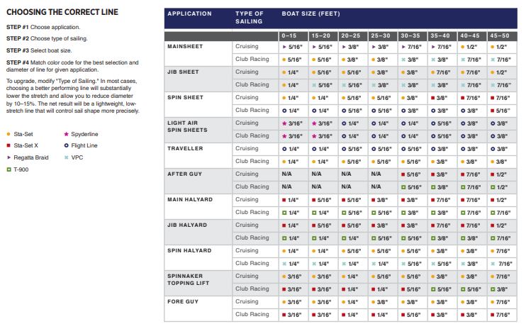

23,803
Flightline is New England Ropes dyneema with a cover. No stretch.
Dacron/Polyester - 3-5% stretch
Nylon - up wards to 20% stretch
Sta-Set is a double Braided polyester line
Regatta Braid is 12-strand single braid made from spun and filament polyester that is flexible and easy to handle.
