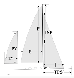

I just purchased a 1985S28.6 and I’m looking for The mast height. Does anyone know where I could find a technical data sheet and or a PDF file for an owners manual of any sort.

The I dimension is the height of the foretriangle from the chainplates. On the S2 this is a good estimate of the mast height, but that is from the deck level where the chainplates are located. The air draft, or height above the waterline is a different number. If you measure from the chainplate to the waterline and add that to the I dimension you'll get a good estimate of the air draft.
Air draft is important for getting under bridges and power lines.

Measuring can be done by tying a tape measure to your halyard and while holding the tape haul the end up the mast.
An almost good way is to use the P number from this spec.https://sailboatdata.com/sailboat/s2-86. Then add the boom to the deck value. You have within 6 inches the length of the mast from deck to mast head.
To know the need height to get under a bridge you need the boats “draft”. Add the height of the mast base from the water. Then add a fudge factor of 5 feet. You should have a safe number to slip safely under the bridge.
