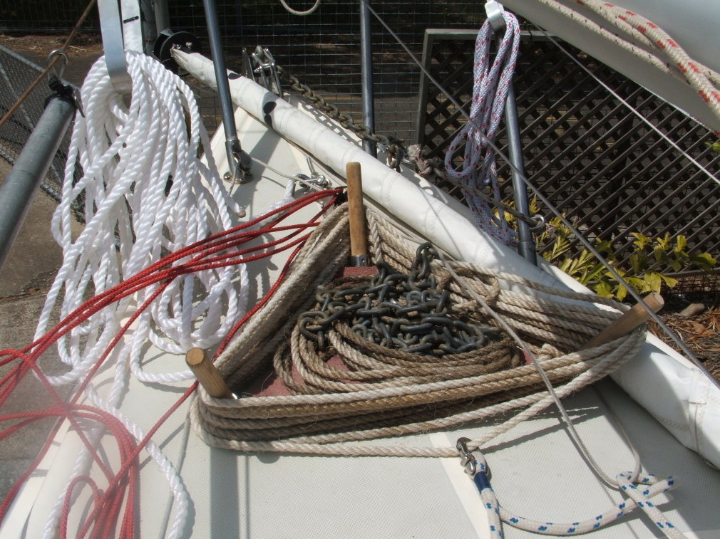

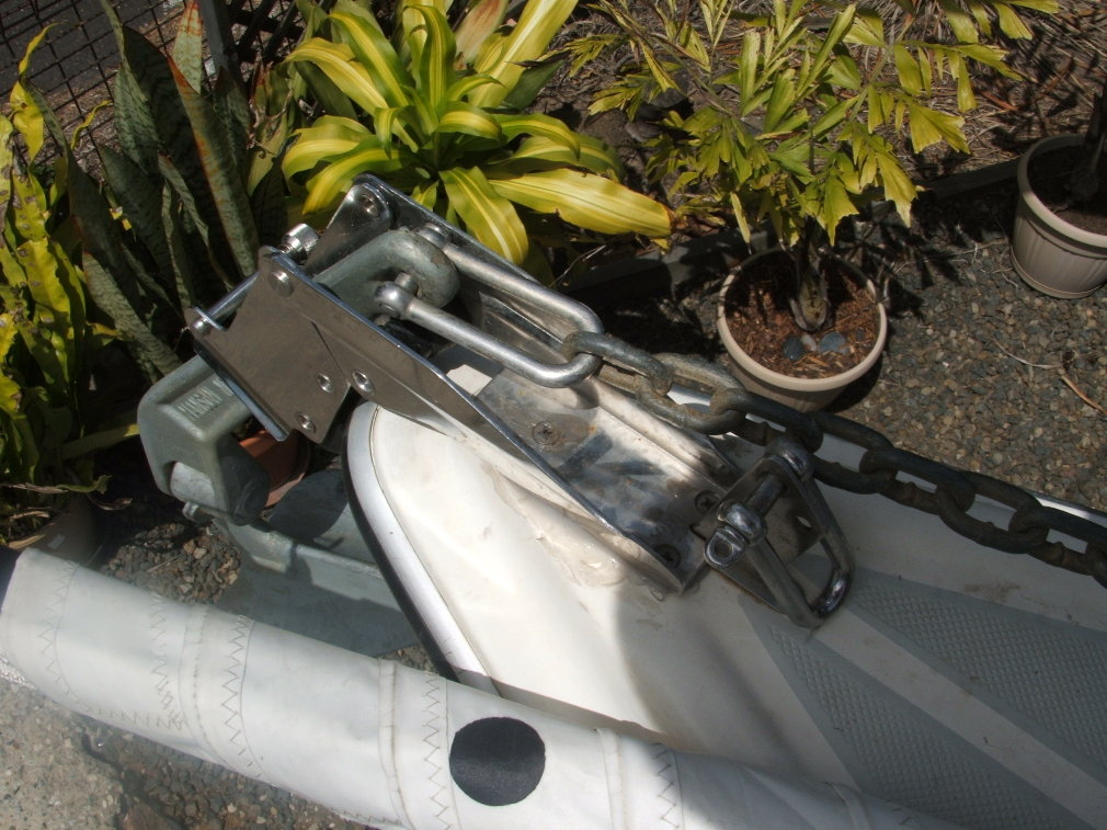

September 2008 004.jpgHi marty,
you can see that if you slot the base plate of the hinged roller, it fits back onto the forestay.
I have included a pic of my solution for not having an anchor well, works great and is nice and neat.

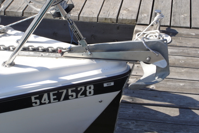

I installed a bow roller on my 26S. I was concerned about the attachment of the deck to the hull in this area. The deck is attached to the hull with s/s nuts & bolts along the hull/deck joint except for the area a foot or two back from the bow, they used s/s screws here. I removed the forestay chain plate and now use the bow roller frame instead. I also used a 1"x 1/4" piece of s/s bar stock from the bottom of my bow roller down the stem of the bow. I reinforced the deck and stem with west epoxy and wood. Having the forestay moved over does not have any effect on how the boat sails.
The bow roller makes a big difference in setting out the anchor as well as bringing it in. It is much easier on the back, and easier on the rode on a windy night.
I have never been happy with any of the solutions I've used to store the anchor rode on the bow. I would like to find a nice s/s reel that mounts on the pulpit to store this line on. I have given up trying to buy one and will eventually make one I think.

Bob, I really like your solution the best of all I've seen. I've been saving pictures of your setup for some time now and intend to apply your solution to my 26S.
I might make one small change though. I'm thinking I could attach a bail to both sides of the roller assembly, attach the headstay to that, instead of connecting it to one side. The only problem I may have is that the headstay may be too long, but I'm wondering if I could move it just a little forward to take up the slack. What do you think?
Do you think a genoa could be attached to that bail thats far forward on your setup?

Doug, yes I think that would work fine, that was my fall back solution if it didn't work on the side of the frame. I've been very pleased with the setup. I thought I might not like to look at it with the forestay off to the side but really it does not look bad and sails well with the slight offset.
good luck, Bob
