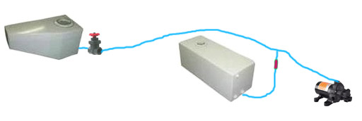

I should also add that the line that comes from the forward tank goes over the top of the settee tank to the pump.
The settee tank line comes from the bottom and goes up to the above line in a T.
I'll draw a picture.
Just saw this...
That is the Routing Problem!
Jim...

If elevations shown in your drawing are relative elevations to each other, then this must be happening...
1) V berth tank is empty or...
2) Water line from V to Pump has a low spot or dip below the check valve top elevation at some piping point.
A leaking check valve would fill the S tank when not pumping.

My picture isn't perfect, so yes, I would say that the originating line from the V tank is BELOW the check valve at the T.
But, the check valve is not working anyway. I think the check valve would only keep the V from filling the S back up.
But, in my case, it's good that it's not working because some of the water I can't suck out might go into the S and get sucked out.
Okay, so correct me if I'm wrong, but it sound like those lines all need to be BELOW the water tanks, and then they'll both drain etc... right? For now, I'm going to go buy a little manual valve so I can suck out the left over V water if I need to.
I'll have to revisit this later.

I just installed a gate valve where that check valve is. I'll leave it open as my "reserve" in an emergency if I need that extra water I'll just close it.
