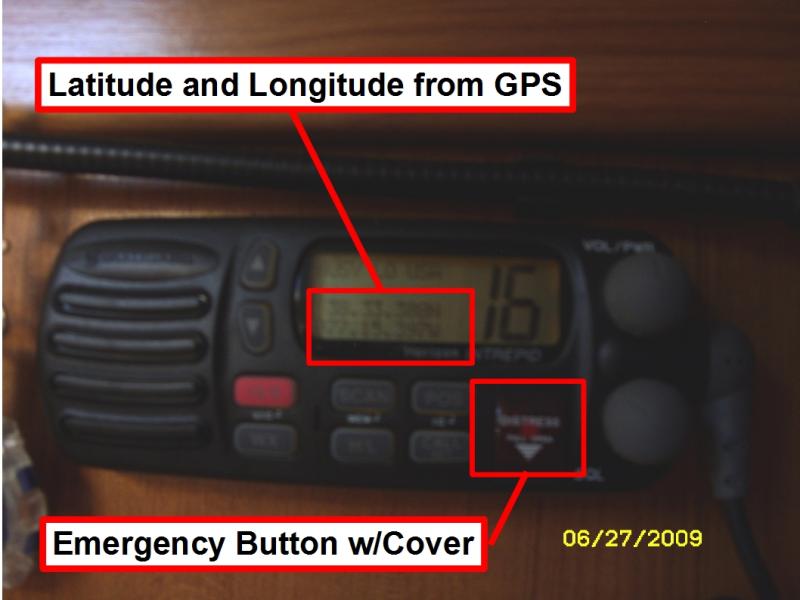

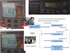

although you would not know it by my boating friends. I have a Std Horizon that was on the boat and it works great. There are only 2 wires from your GPS/Chartplotter to the radio. I have attached some pictures to show you what I did.
You may want to see if there is one out there that has DSC with a built in GPS and/or perhaps AIS as well.
One thing I will note is that I also tied the GPS to my autopilot (note the Bearing to Waypoint [BTW] and the Distance to Waypoint [DTW] readouts). You will also see my garmin in the wiring diagram as well as my Humminbird; I have not used it in years and would only plug it in if the Humminbird (which is awesome BTW) failed as to run both at the same time would be bad mojo.:D
I will also note if it does not work at first check your grounds as the signal is very low and any float on your signal ground will make it not work. As you can see on the radio display, you know it works when you see lat and long. Finally Std Horizon support was awesome.

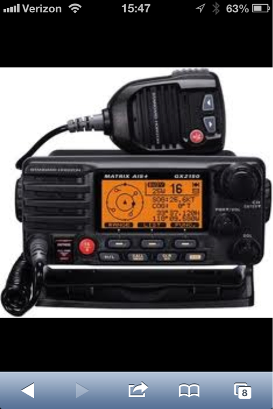

The SH 2150 matrix has a large display with dsc and AIS capabilities. Installed mine in October and will be integrating it with my GPS (when I buy a new one that is compatible) in the spring.

Yeah. I like the separate radio and head. The RJ-45 plugs will make it easy to just take the head and stow it away when not in use.
Interested to see the price when it's released. Heading to AC Boat Show next week. Will see if they have one. Not that I'm buying since I just installed my new one in Oct!
