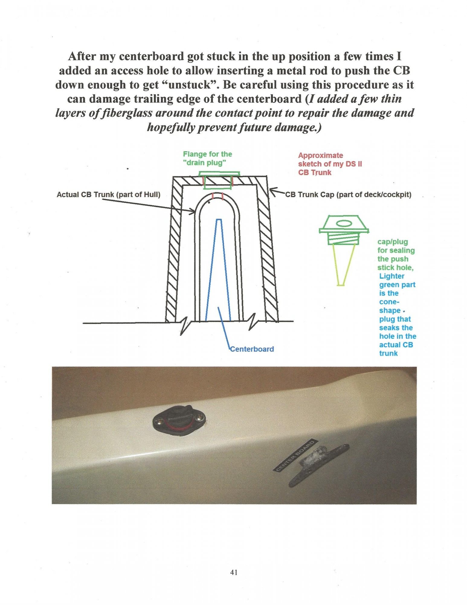

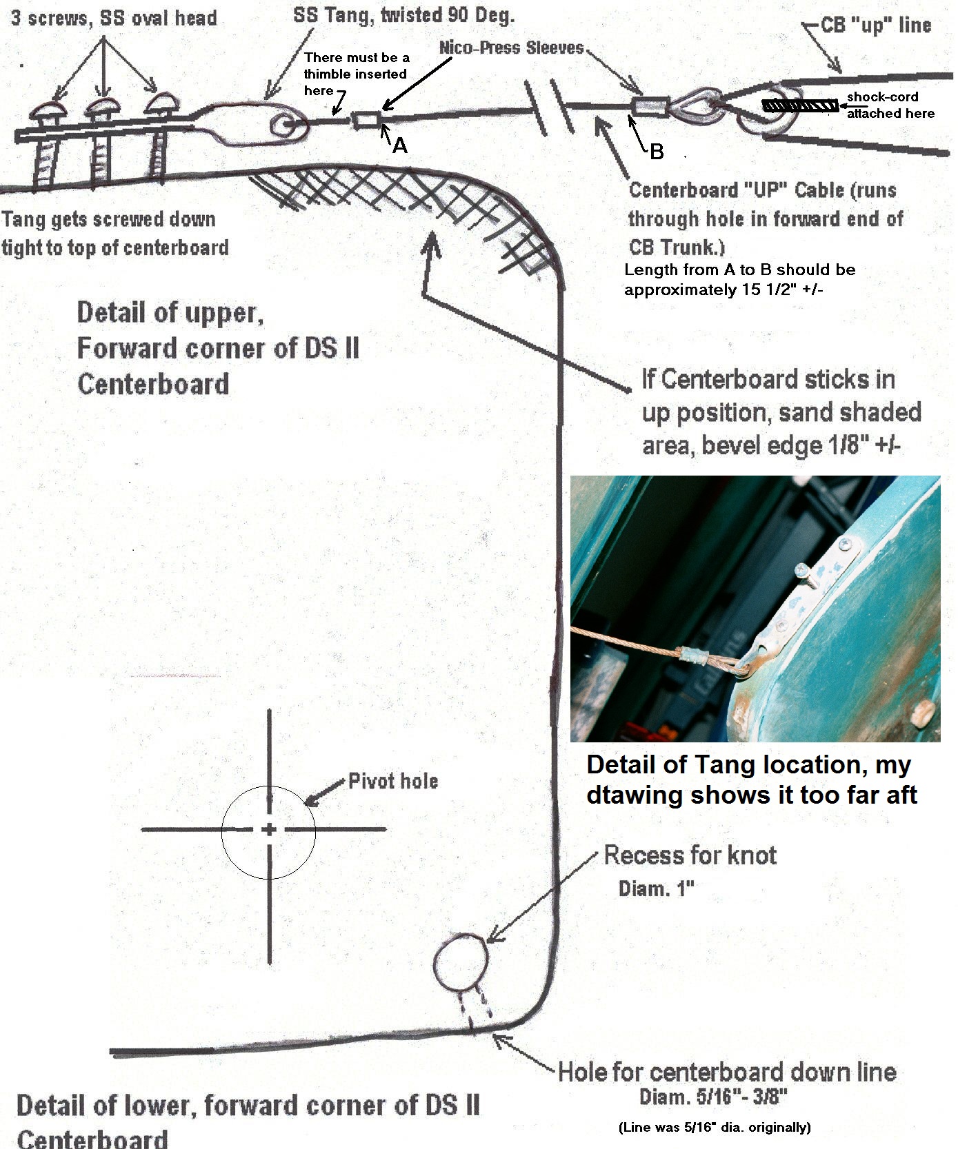

Is the bushing a bit longer than the CB trunk is wide? That is needed to give room for the CB to pivot without jamming (CB pivots on the bushing, not the bolt, so bushing need to be able to turn in the hole in the CB. My CB was a bit "sticky" when I got the boat (1979 model, I bought in 1996), I ended up sanding the top forward edges of the CB a bit and that helped, but it still can jam if pulled all the way up. I added a little hole in the top of the CB trunk to insert a push-stick to free it up if it sticks.
