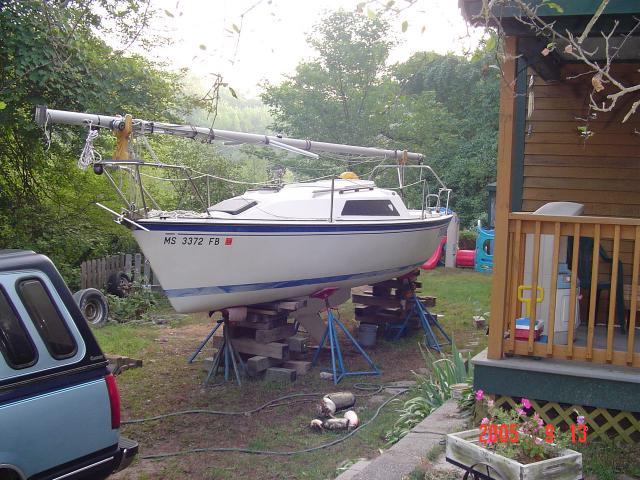

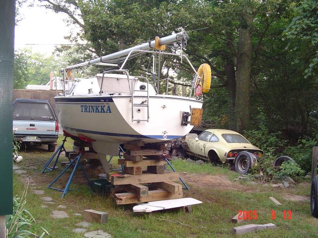

You could place some old tires under it, or you could use some wood blocks and criss cross them as you go up. Some old carpet can be used in between the hull and the blocks. Also, you would need to Mickey Mouse some kind of an easy to build cradle to keep it from tipping. Some small sailboat stands would be ideal in this situation because they could lift the hull up and support it at any height without a cradle or the blocks. I would still shore up under the centerboard slot with blocks though.

As far as blocking hte boat up, Joe's idea of using old tires may work, one under the bow, two under the stern. I wouldn't invest in boat stands ("Brownell stands" or jack stands) because they will most likely place the boat higher than you want. The BEST way to support the boat off the trailer would be a cradle, use a pair of 4x4 runners on each side with 3-4 crossmembers (2x4 laid flat or 4x4) a plywood support cut to match the hull shape at the forward and aft most cross members would help a lot. Look at an old-fasioned "shipping cradle" for larger boats as a reference.

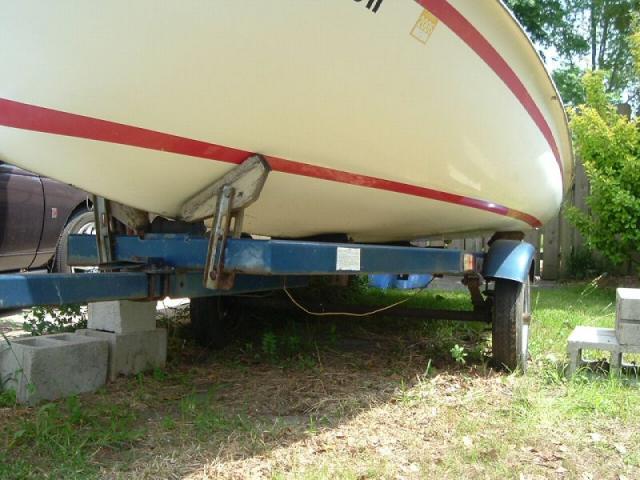

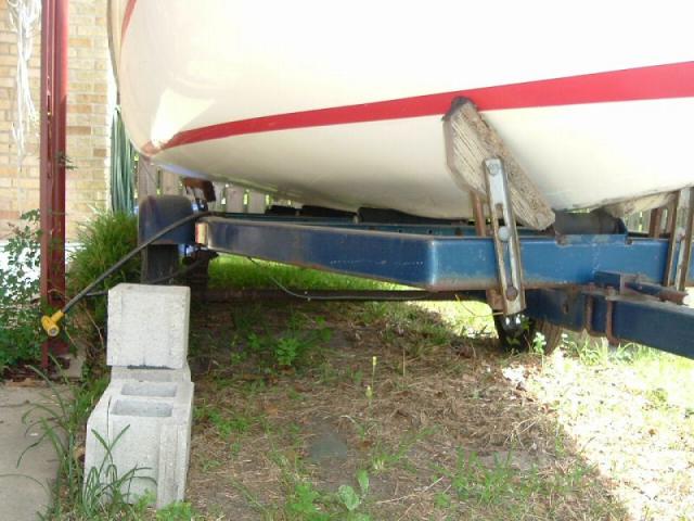

The DS II hull can be a bit "soft" not a real big problem if in hte water or on a proper trailer, but the bottom will flex a bit (mine actually "sags" a bit over the winter) and although any areas that may dish in will pop back out... it is still best to block the hull carefully. I'll post a pic of a DS II on a trailer, that should give an idea of where to place blocking. If you do actually have a trailer, but wish to remove the boat from it while you store it, check how it is setup, that may also give you ideas for how to block the boat up.

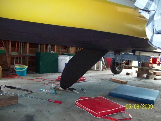

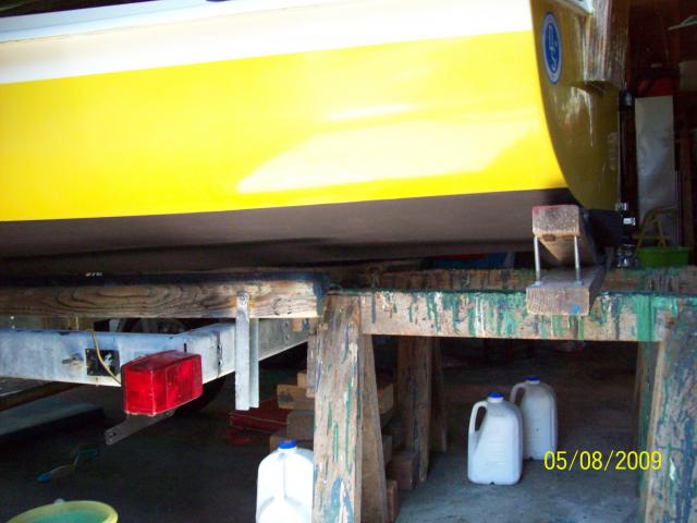

I have never rolled my DS II over (too much work), but the easiest way to replace the masthead Spar-Fly on my Old Widgeon was to pull her up on marsh, grab the mast and pull her over until I could reach the masthead. Too much gear in my DS II to do that! The previous owner of my DS II used to roll her up on one gunwale and rest her against a cement wall to paint the bottom......... I'll stick with my method of pulling her halfway off the trailer with the stern resting on a beam between 2 saw horses.
