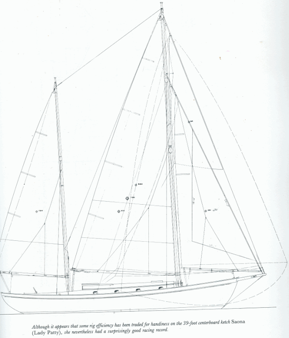

Somewhere on the Chessie is one of the three Saona's still sailing.
Fair Zyphers,
Ed K
See picture below comments:
