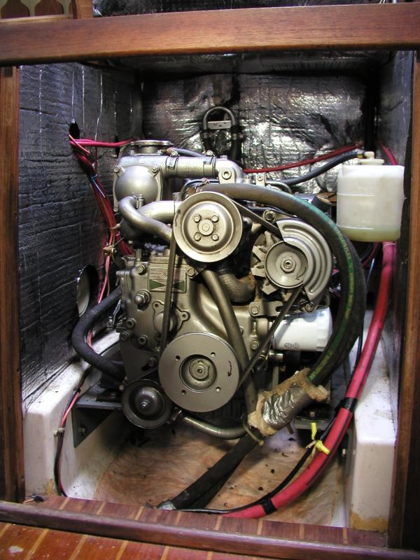

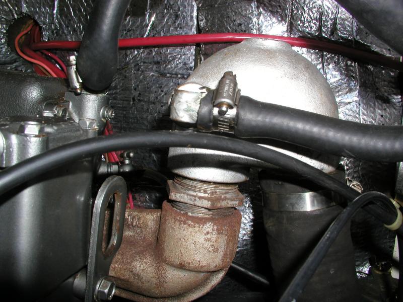

Catalina.. here is a shot of the elbow on the Yanmar 3GMF.. the water injection point is on the "uphill" side but as others have noted, there is a water jacket thet contains the water around the top and the internal opening is on the "downhill" side.. The other picture shows the anti-syphon loop in the cooling line after the engine and before the exhaust ell. It is the little stainless loop on the aft of the engine box, higher than the exhaust ell. There is also a high loop in the exhaust hose itself after the muffler . In the Cat 30, could the anti syphon loop be up under the sink?
