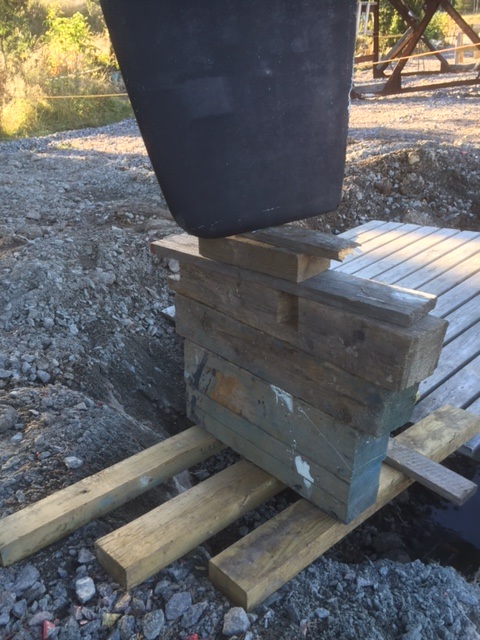

First dig the hole and put something under the rudder, see pictures, how I did it.
Then just loosen up four bolts from quadrant, no need to remove them. Remove the pin from quadrant. Then remove the pin from collar and the rudder should come off. No need to remove cables from quadrant.
After this, I just broke down the pile under rudder and the rudder came off nicely (I did whole thing alone and took about 20min after the hole was ready

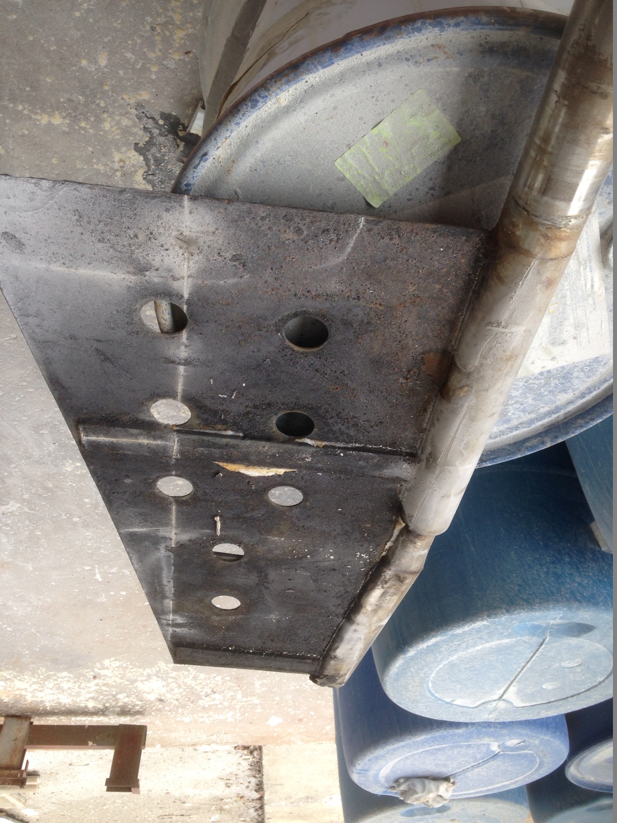

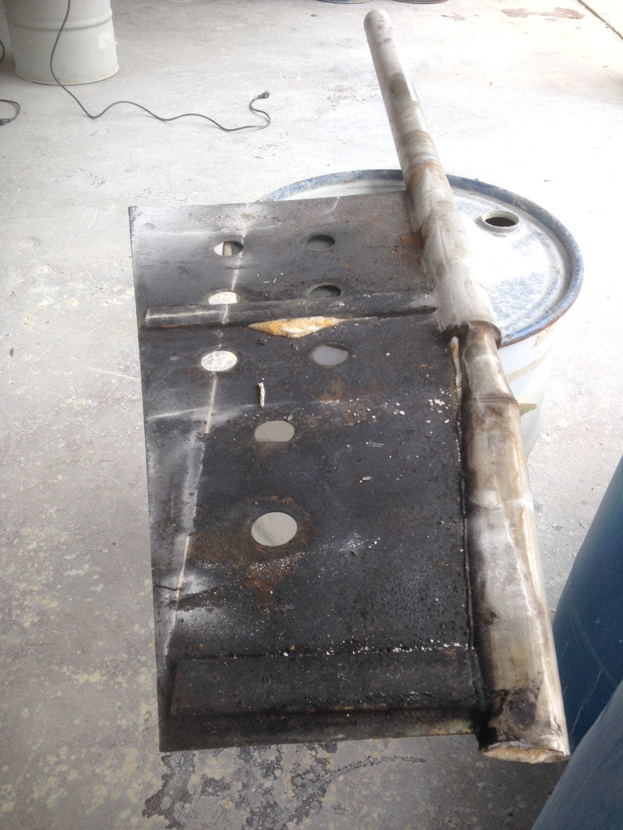

This will be an update on my earlier post. I didn't do the repairs myself. I'm not that proficient with fiber glass and I know it. I did drop the rudder off at Foss Foam in Williston, FL. They tore it apart and notified me that the interior was quite saturated with water, but the steel inside was still in good condition. I'll attach a picture of it as a skeleton of the rudder. Looking forward to picking it up in a few weeks and I'll again update after that and when it is back on the boat in April.
