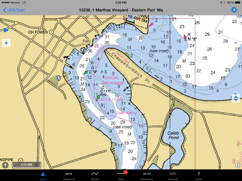

I know that there are some anchorages that you can't use without permission of the Harbor Master. For instance, the inner basin in Edgartown on Martha's Vineyard. The cruising guides and active captain both said you needed permission but I don't think that the charts noted this.

Edgartown Inner Basin??????
I've been going to Edgartown for 35 years and I have never heard of an "Inner Basin". Could you please explain what/where that is?

In Annapolis, there are special anchorages on charts (you'd have to read note "A") for naval academy vessels use during hurricanes. Otherwise, they are usually free to use... maybe whith the exception of when subs and frigates are here.
