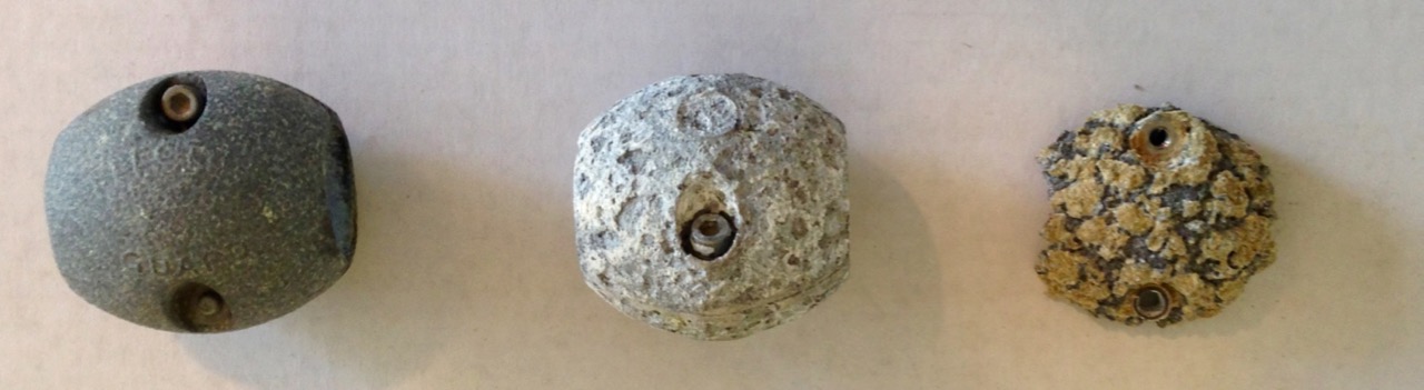

If the anode is nice and new looking and its been on your boat in freshwater for a while, it is probably zinc.
Order a new magnesium or aluminum anode compare the weight of the new magnesium anode to the old one. The one that is much heavier is zinc. In the photo below, 3 anodes, zinc, aluminum, and magnesium all from the same freshwater boat. I don't know how old the zinc one is, the aluminum was on for 1 season, the magnesium for 2 seasons. The zinc was clearly not living up to its name, sacrificial anode.
