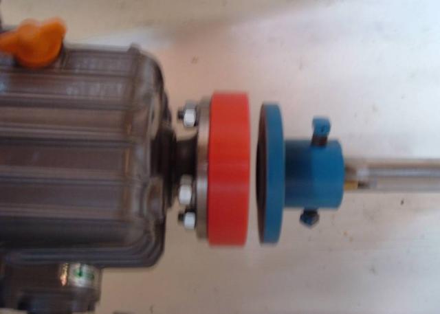

I wanted to fit a rope cutter to my prop but this would mean moving the propshaft back about 1 1/2". This provided an ideal opportunity to fit a flexible shaft coupling.
I had read lots of uninformed comment on various websites regarding alleged problems resulting from the additional shaft overhang so I did the calculations and it was okay for my 1" diameter shaft length and maximum prop/engine speed.

and the R & D Flexible Coupling see:-
http://www.randdmarine.com/flexiblesc.asp.

Note the Flexible Coupling makes NO claims to be a drive saver.
What it does, being slightly flexible, is to much reduce the need for precise alignment of the gearbox and shaft flanges - and, of course, makes an ideal spacer for the Stripper.
