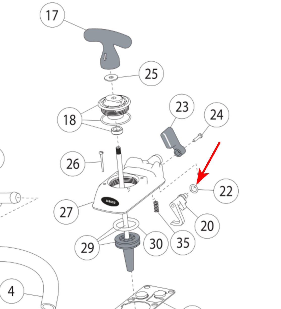

The problem is that O ring #22 is leaking.
Initially, slather the old O ring with a NON-PETROLEUM grease such as SuperLube :
........... and see if that works.
If not, see if you can find a replacement O ring at a hardware store or Amazon. The Jabsco repair kit is about the same price as a whole new head.

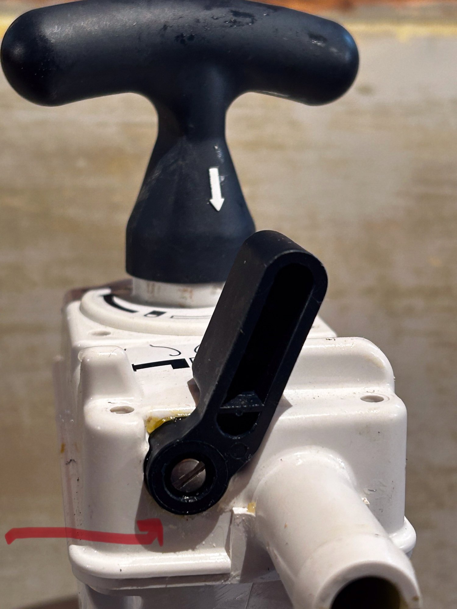

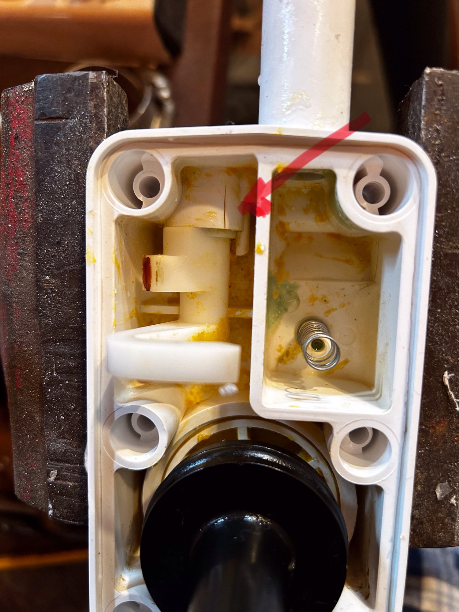

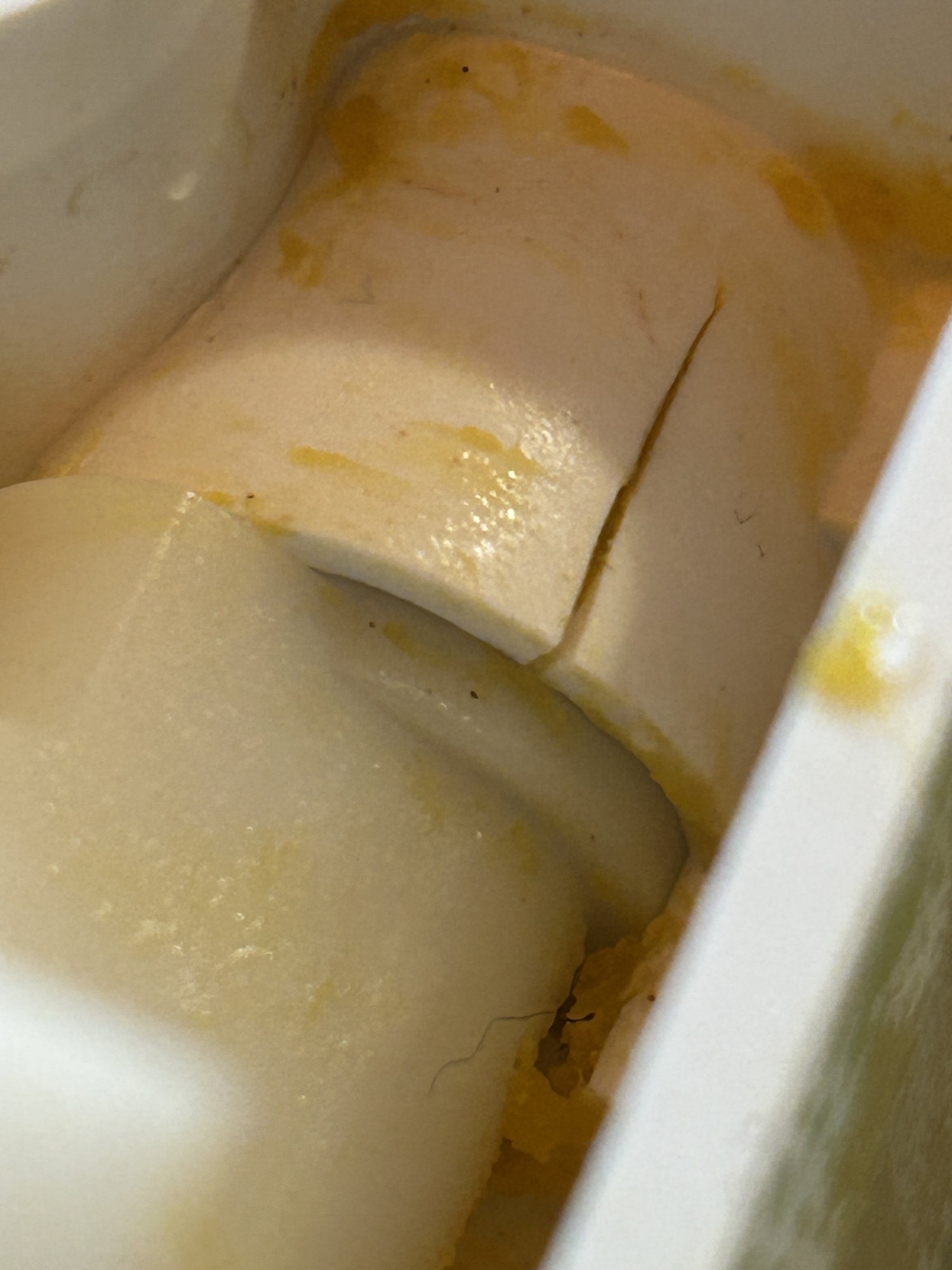

Here are the photos of what I found.
How, I don’t know, but somehow just didn’t get the water out and the antifreeze in last year. And it wasn’t a particularly cold winter. Rather mild if I remember correctly.
My word of advice, don’t leave out the removal of the intake hose and pump through the antifreeze. I don’t remember how much antifreeze I used, but obviously it wasn’t enough.

What a miserable, rotten, SOB to have that happen. I doubt that it's even worth trying to get some crazy glue in there to see if that will seal the leak.
My condolences :mad:.
