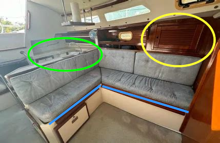

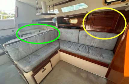

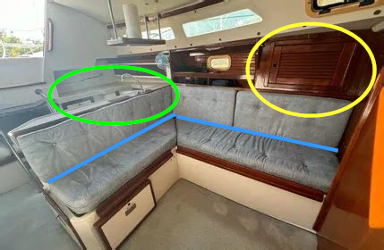

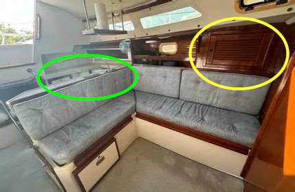

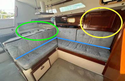

Where would you mount the tube for a PSS dripless seal? My options seem to be on the port side just below deck level or inside the galley cabinet closer to the centerline?
Port side: The port side is higher except for when healing. The head intake through hull is in this location. I love heeling so the rail does get buried sometimes
Galley cabinet: The sink will dip below the waterline on occasion in heavier waves. The sink has never overflowed so it seems to reason that just below the countertop would work
Waterline is approximately where the blue line is

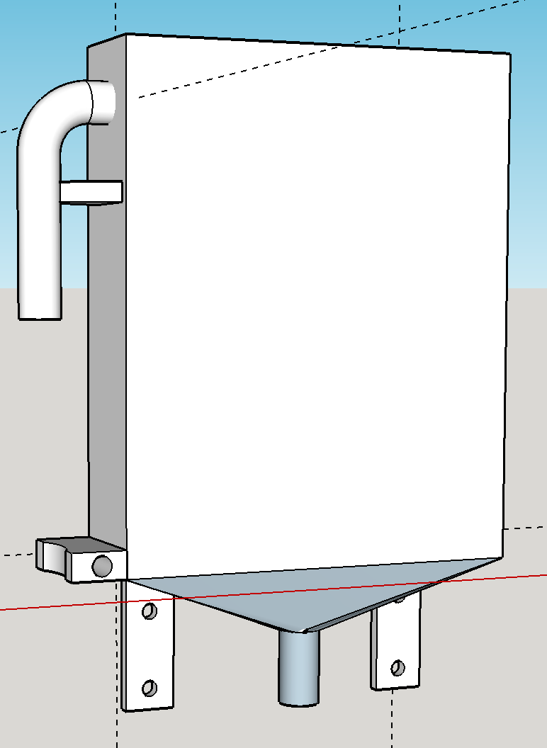

I designed a crude catch can in the unlikely event that the vent tube overflows. It has an attachment for a drain tube.

The bottom of the sink in the countertop is below the waterline in heavy waves. I had water occasionally coming up the drain before in installed a check valve. The top of the engine compartment is at the waterline.

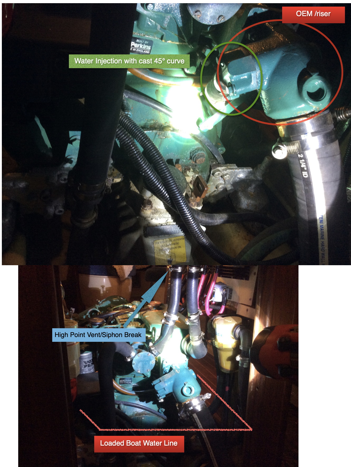

Well maybe.Thats where mine was originally installed. And every time the engine was put in reverse the water would shoot up at least a foot up out of the tube soaking everything including the engine and all the wiring in the engine compartment. There was no possible way that much water would evaporate.
The solution was to extend the vent up to a new through hull that was installed in the topsides just below the rub rail

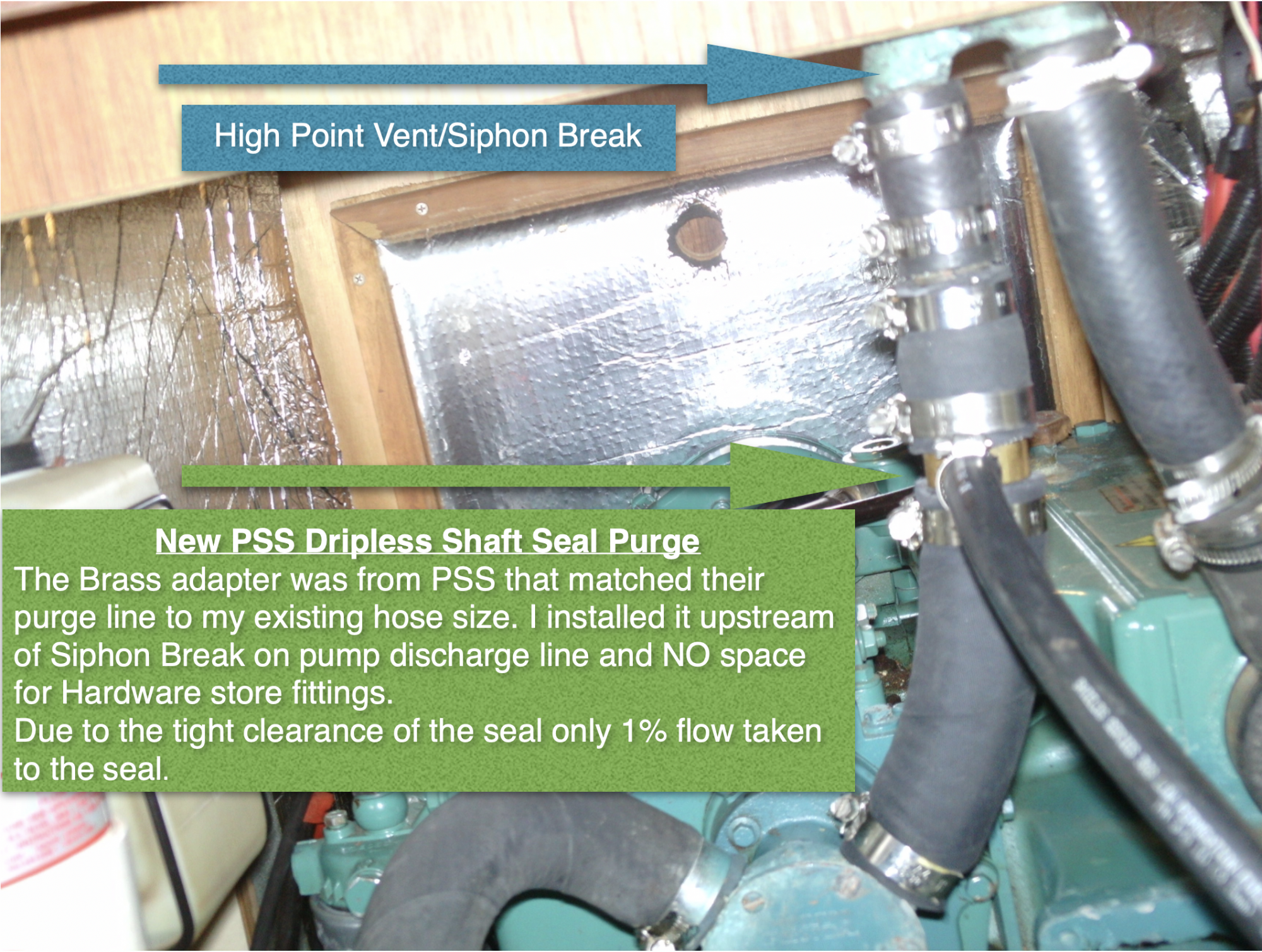

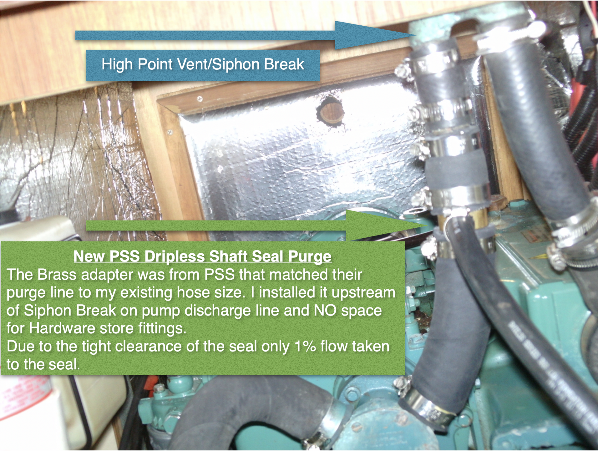

This how I did mine, after talking with PSS techs.
Good Luck...
Jim...
PS: Brass is protected by my shaft Zinc
24,925
If you're not going to run water through the nipple, then you just need to attach a hose (double clamps below the waterline) and run the hose vertically above the water line near the center of the boat. It is unlikely that you're going to subject your boat to a knockdown (lay her on her side with the mast touching the water). My calculations: measure from the nipple to the waterline in height. Then multiply that number by 2.5 (nipple to boat water line 12", multiply by 2.5, gives you a 30-inch hose that you run vertically), and you are more than safe. Hose is open to the air.
