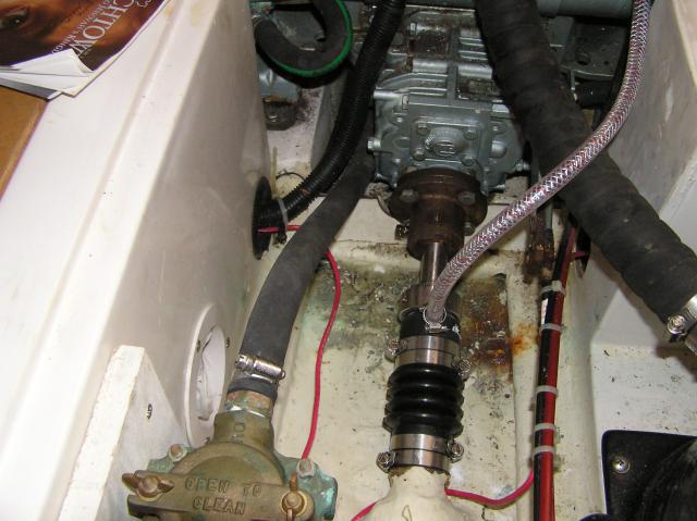

If your dripless shaft seal is the PSS brand, the fix might be very simple. There are two highly polished surfaces that mate with one another at the end of the rubber bellows closest to the engine. One part is carbon which is attached to the bellows and the other is stainless steel and attached to the prop shaft. If any debris gets between those surfaces you will have a leak. If your boat is in the water, grab the carbon part attached to the bellows pull the bellows slightly back toward the stern for a second. Water will rush into the boat which should flush the debris away from the mating surfaces. This process should also be done anytime the boat is placed back into the water after a haul out. "Burping" the bellows removes any trapped air so that water can reach the mating surfaces. Some PSS models have a water supply tube which are usually used on power boats so this burping process isn't necessary as water is supplied via the tube as shown in the left photo of the previous post by Paulj.

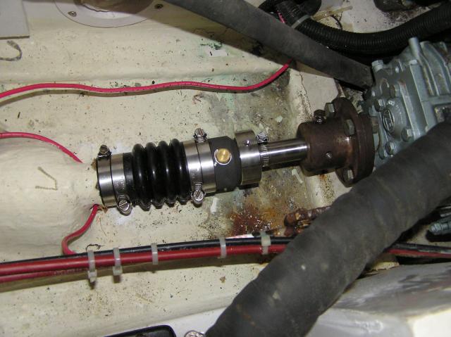

PYI PPS installed.
paulj :troll:
PS The debri has been cleaned up..........
Paul,
Is your seal currently installed with the vent or without? If it is without please do yourself a favor and remove that brass plug ASAP! There is a reason PYI supplies nylon barbs and vents with their seals. As that rotor heats up the brass will expand at a differing rate and could SPLIT the carbon bearing. Also the two products are galvanically not compatible. If you want to plug it please use a nylon plug and not a brass, bronze or stainless one.
I also don't suggest running a PSS without venting. PYI made this standard on all seals low or high speed with good reason. The Catalina's in particular have a nasty habit of trapping air bubbles in the seal which leads to loss of lubrication and massive amounts of heat at the rotor/carbon interface. This can happen from sailing in rough weather or a quick blast of reverse and the resulting cavitation/air bubbles that go along with it. This trapped air is usually cumulative cause once it is up in there it does not come out until you burp the seal.
I'm am guessing that you bought the boat with the plug and hopefully converted it to vented..

PYI PSS was installed by a well known local company who also replaced my propshaft.
The PYI dealer caught the error and sent me a free nylon barb.
