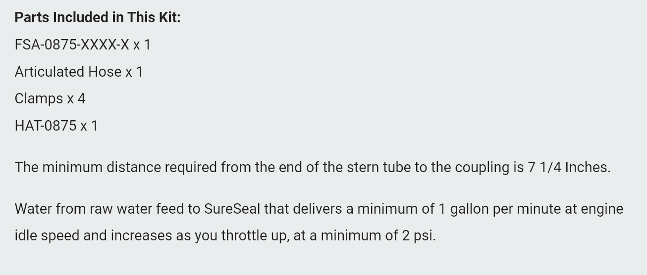

If they are telling you the thru-hull that supplies sea water to the engine, bad idea. The raw water pump pulls from this hose and the hose is under negative pressure before the pump. I would think this would melt your seal.
Wouldn't the pump be pulling water from both the thru hull and the shaft log? That would bring cool water in through the shaft log, past the seal and then into the engine.

And yet here the fitting act as a vent and not a supply of water. I dunno. Does the SureSeal require a source of slightly pressurized water. The one thing I do know is that a negative pressure supply is not what you want connected to the seal.

Why not? The vendor themself seems to say it’s ok, and as Dave pointed out either negative or positive pressure will pull water through the seal, just in opposite directions.

These are obviously the instructions for a power boat :
I'd really feel more comfortable if their general instructions had additionally included alternate instructions for a sailboat. It's the fact that these seals are so unforgiving when something fails that keeps me o edge.
Their recommendation was not to hook it to the engine, but to hook it to the engine's thru hull fitting. This will provide enough flow, especially in a sailboat whether the engine was running or not.
How do you get flow through the seal when under sail ? If the injection point is connected to a water supply, it can't act as a vent as does a line which only extends above the water line and vents to air.
The vendor doesn't really know squat about the products he's selling. He's just there to get you to buy something, anything. It's the manufacturer you want to talk to for the technical requirements. Ask them, as a sailboater, do they want you to install their seal so that it has :
1. A supply of slightly pressurized water for flushing their seal.
OR
2. A vent to eliminate air from their seal.
You can't have both. And powerboaters don't have sails. They shut down the engine(s) and the prop stops.
