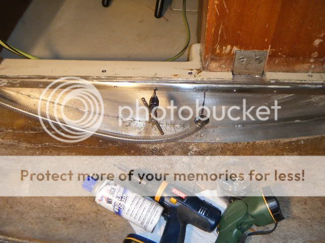

OK, I'm on my 3rd hour and 3rd bit, trying to drill a 1/4" hole in an 1/8" piece of Stainless Steel. The advice from others was "slow and hard" so I'm drilling about 60rpm (1 rev/sec), with about half my body-weight (100 lb) on the drill. My first two bits were titanium, the last was cobalt, and the cobalt seemed to "bite" a bit better than the titanium.
Barring any other advice, I'll buy another cobalt bit and try again tomorrow.
Any advice?

Yeah... a drill press would be nice. Tell me: how do you get the boat under the drill press? (as you know, ANY work done on a boat is with you on your back, legs tucked up, one elbow pressing on something while you're pushing the drill "up" and backwards, with the shavings falling into your eyes...)
This one is actually quite easy - I can stand up and push the drill DOWN. I'd have to take the pedestal apart to get the piece under a press, though.
You may be right about work hardening - the first bit got a bit hot despite the oil. And forgive me if I stop after 5 minutes - I'm not in that great shape! As for industrial bits: it's Saturday and the "good shops" aren't open. I'll try KMS - they may be open Sat, otherwise Home Depot is the best I can get.
