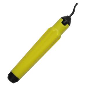

You can buy a de-burring tool from Home Depot for about $7.00. It does a great job with the exterior side and a pretty good job on the inside as well with a bit of twisting. This tool should be in everyone's tool kit. I use mine all the time. It works on metal, and plastic very well.

Thanks for all info. Round files too short, de-burring tool seems the ticket. First time I've heard of it. Will look it up. Improvise using a long threaded rod, very MacGuyver like. I like the idea. Thanks again. :)
