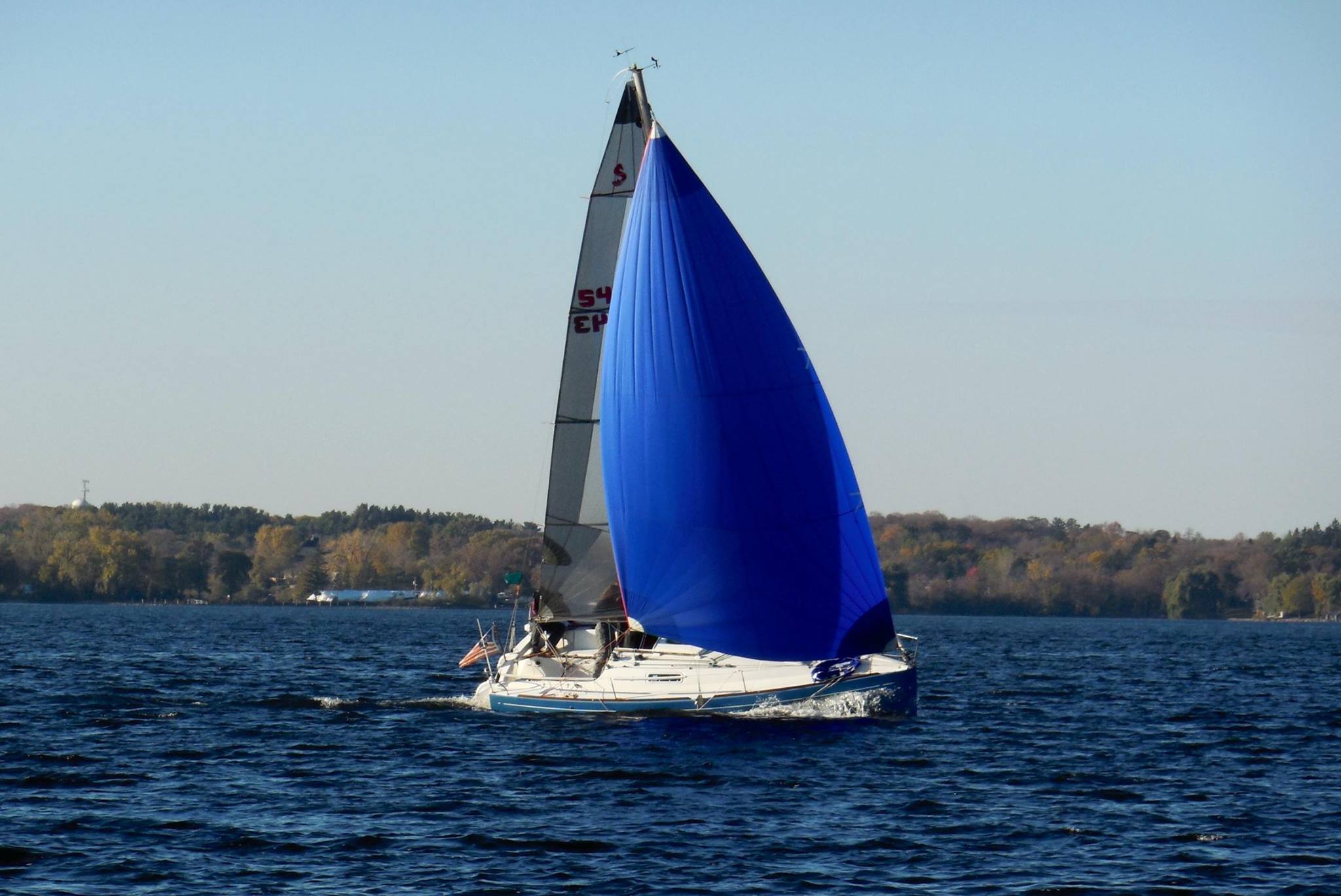

I'm not disagreeing with the 35 AWA, just saying that in real life (true wind) you really can't go to windward with a civilian Code 0. The boat speed pushes the apparent wind so far forward that it seems like you are going upwind, but you really are not.
Doing 7 in 8 knots true. Looks like we are going 'upwind', but the true wind angle is just ahead of the beam. We try and go higher the luff collapses.
You can however go upwind with a drifter.
