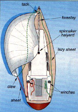

You want to locate the blocks at the stern. You are going to fly the drifter high and out in front of the boat like a balloon.
Here is the basic set up. You may seek to pull the sheet down and in at some point. Do this with a tweaker on the sheet.
