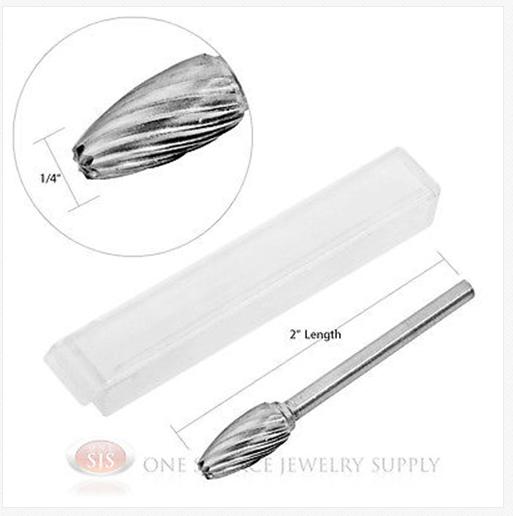

I use the little stone tool in the Dremel, rather than the carbide grinder bitt. I find it gentler and more controllable. Also it is cheaper. And it lasts as long as you'd care to use it-- I've done about four boats with the current one and it's still fine.
