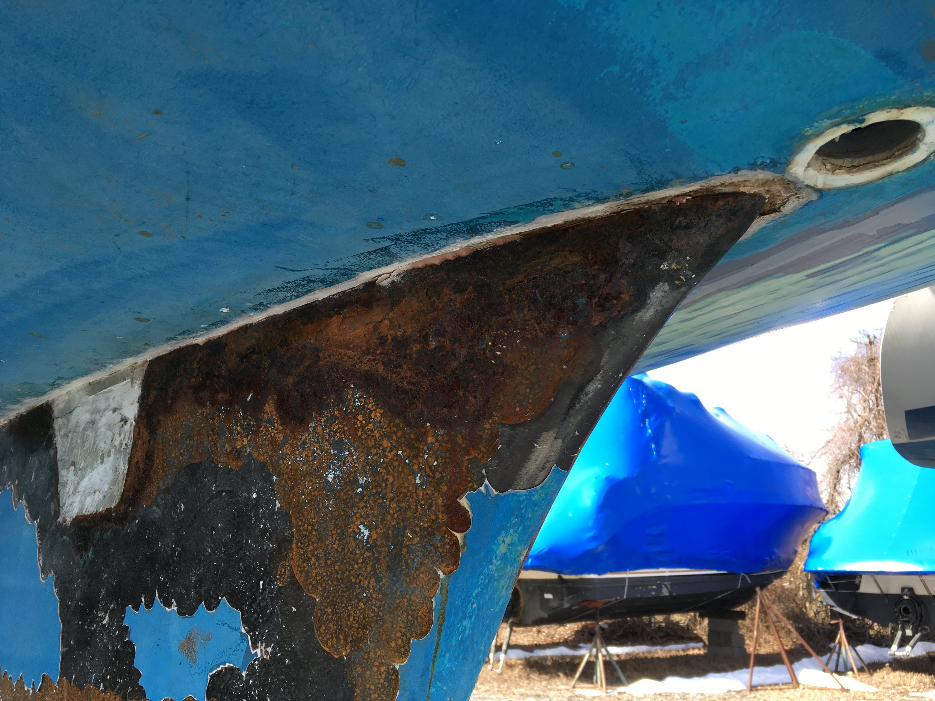

Title says it all. Got good reason to suspect my keel/hull joint as per attached photo.
Next valuable piece of information will be assessing the state of the keel bolts themselves. So here's my first question: anybody got the proper torque spec for a 1985 First 29 keel bolt?
Next question would be what's the best thread compound to be using on said bolts? I removed one so far (looked surprisingly good) and it had a pinkish, still moldable putty on it.
And this could probably be its own thread but for the potential rebed: 5200 versus a sikaflex product? And in my case, I'm putting a copper epoxy bottom on the boat--here I'm concerned that there is a "flexible" seam and I'm going to put an inflexible epoxy coating on top? Almost seems that I should leave a seam between the copper epoxy on keel and hull with whatever seam sealant I use....

So I'm really, really, REALLY hoping NOT to rebed. But:
There is a visible separation on the forward section of the cast iron keel running approximately two inches aft. There has also been persistent water in our bilge (though there are multiple problems here including leaking deadlights and a faulty check valve in a long bilge pump run so we really don't know what the source is).
Our storied hull seems to have had (from outside in) two coats ablative antifoul on top of two coats hard racing paint on top of some manner of original looking barrier coat.
We are looking to put on a new copper epoxy bottom. And hopefully live happily ever after. Hence, all this work to ensure a stable foundation to build upon.

Yeah, well there will be no soda blasting in our budget. There is moaning, cursing, a burning sensation in the upper extremities secondary to hour upon hour of above the shoulder grinding at 60 grit.
The keel is just epoxy paint on cast iron--here a beater chisel and my trusty deadblow chips it right off. Highly recommend eye protection to anyone who follows suit.
This is my first year with the boat. I have no knowledge nor is there any other sign of a hard grounding. Stringers inside look good. No significant stress cracking in layers below as the ablative comes off.
Again, really hoping not to drop the keel. Just need that torque spec and a thread anti-seize recommendation as I will be replacing the bolts one at a time at the very least.

Yeah, well, someone omitted the line for soda blasting in this year's boat budget. So there is no soda blast, only moaning, cursing, burning sensations in the upper extremities secondary to hour upon hour of grinding above the shoulders with 60 grit. We're about 60% there at this point.
Notably, the cast iron keel just has epoxy paint over it. This comes off rather handily with a beater chisel and my trusty dead blow mallet. Highly recommend full face shield to anyone who might want to follow suit--the chips do fly off with some energy. And they're sharp.
This is my second year with the boat. I have no knowledge of nor is there any sign of a significant hard grounding. Stringers intact. No stress cracking seen underneath the ablative.
Again, I am really, really hoping to not drop the keel. The next step is to inspect and replace the bolts one at a time. And to do that I need to figure out the correct torque spec and the proper type of anti-seize compound.

i'd try to find out if the h 2 0 in the bilge is weeping 'up' from keel bolts or 'down from ports or chainplates. draw a line around the circumference of the bilge with kids water soluble finger paint. go away and see if the paint gets washed 'down' towards the bilge by h 20 coming from above . if so you may not need to do anything to the keel bolts...

Do you have water in the bilge now? If so do you see it leaking out of the keel joint from the outside? I’m just wondering if your water in the bilge is from other sources. I would hate to see you waste time and money on rebedding the keel if not necessary.
