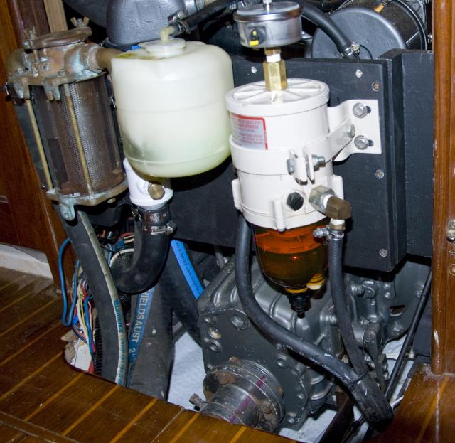

I HIGHLY recommend the 500 series Racor.
The see-through bowl will collect water where you can see it. The petcock allows you to remove it easily should it happen again.
The much larger filter element is not only cheaper, it will swallow a great deal more dirt before packing up. Diesels draw a relatively small amount of flow so don't size the filter based on flow rates. Many people miss the much more important issues when focusing on this.
Further, with the optional vacuum gauge you can keep track of how dirty the element is (more vacuum means the element is more plugged) before the engines quits. We all know this will happen at the worst possible moment. Now that they have a drag pointer you can even check the highest vacuum value after the engine is shut down and cooled off. This allows you to be proactive.
I consider this to be one of those "don't leave home without it" things.
Good luck.
Oct 14, 2005
2,191
Rick...
nice installation, with everything easily accessible in a crowded compartment!
Alan
