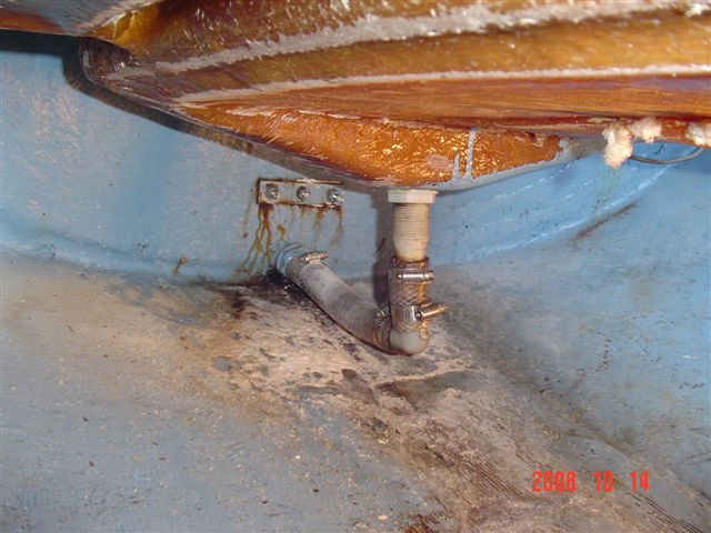

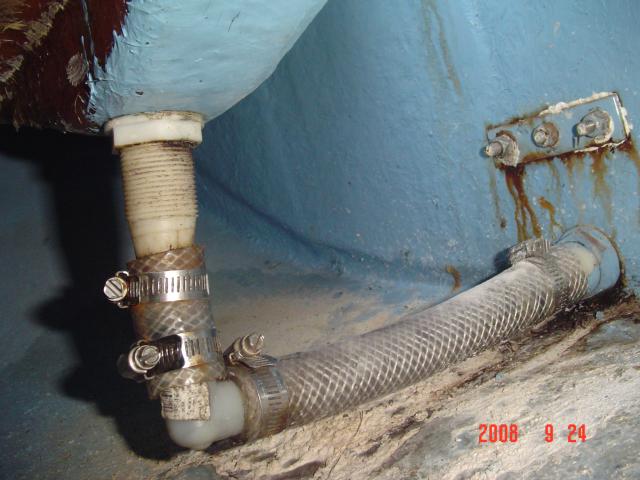

You shouldn't need drain plugs on this boat if the hose under the cockpit floor is good and not leaking. The way is works is; the sole or cockpit floor is higher than the waterline and whatever water should come in, will empty into a small well near the transom or stern. The hose is located under the well and is connected to the through-hull fittings in the well and the stern, just below the waterline. There could be another drain with a small threaded plug on the transom of your boat that could take care of any water that should get into the bilge, I don't know. My O'Day 222 has a self bailing cockpit and they are designed so that when water comes into the cockpit, it goes right out automatically.
I think you're going to need to find out if the hose under the cockpit floor of your boat is good and not leaking. I'm really not too familiar with the Javelin. Here's some pics of my boat so that you can have a better understanding of how the system works. The first two pics show the hoses. Actually, my boat came with one hose with a 90 degree bend in it and I Mickey Moused it with two hoses, a 90 degree nylon fitting, and a few stainless steel hose clamps. You can see the small well in the next pic.
I installed that deck plate in the center of the transom to aid me in working on that hose and getting at the two gudgeons that hold the rudder. After getting stuck in that lazarett hatch one day, I decided to find a better way. This last pic shows the thru hull on the stern near the waterline.

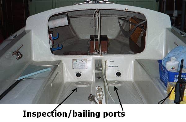

Sandi, I think the JAVELIN has a pair of inspection/bailing ports near the forward end of the cockpit? My DS II has them and it is not unheard of for water to seep in around the perimeter of the frame if rainwater builds up in a rainstorm, a bead of silicone sealant under the frames will help, the ports are held in with sheetmetal screws and are not hard to remove to rebed. Also, the original ports did not have a gasket in the plug. I replaced mine (they are a standard 4" screw-in port, Beckson is one name brand) since the caps were broken (leaks!) and the new ports have coarser threads making them easier to open/close. I did have to use a rasp to slightly enlarge the holes in the cockpit sole to fit the ever so slightly larger frames of hte Beskson ports, coarse sandpaper will work also. If you had 4" of rainwater in the cockpit I suspect it also may have leaked into the bilge around the hatch to the bow compartment.

You have been such a huge help. There are 2 ports held with screws at the front of the cockpit so I will get silicone sealant and will look for the newer Beckson ports. Thank you again! I shudder to think what could have happened without your advice on this website.

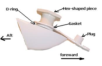

Does any company, organization or website sell the "javelin self-bailing system" or its parts (ball and pin) that was mounted on the DS II?

D&R Marine www.drmarine.com or (508) 644-3001 has it in stock and avaialble online. Price is about $45 complete. If you call Rudy Nickerson (don't bother with e-mail, phone call is best!) he may be able to sell you just the parts that you need, but it is most likely worth replacing the entire unit anyway.
Wait, is that Fairhaven, MA? Call Rudy to make sure he will be open, and if so... drive up there on a Saturday morning, Rudy is open for walk-in customers almost every Saturday from 9-12. He is on Water St. in Assonet (Freetown). It is only a 15-20 minute ride for you. That way you save the shipping cost.
