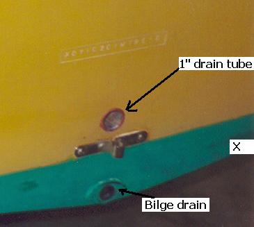

If you are refering ot the 1" rubber drain plug positioned about 1" above the waterline that "drains" the cockpit, it has to be inserted from inside or else it will prevent you from mounting the rudder. I wanted to install a flapper over the outside of mine so I could maybe leave it out on hte mooring without having a lot of water flow IN, but found that there wasn't room between the transom and the rudder and it would prevent the lower pintle from being inserted into the lower gudgeon.
The self-bailer (sorry don't have a picture) has a plug on the inside, but you can't really reach the outside with boat in water.
