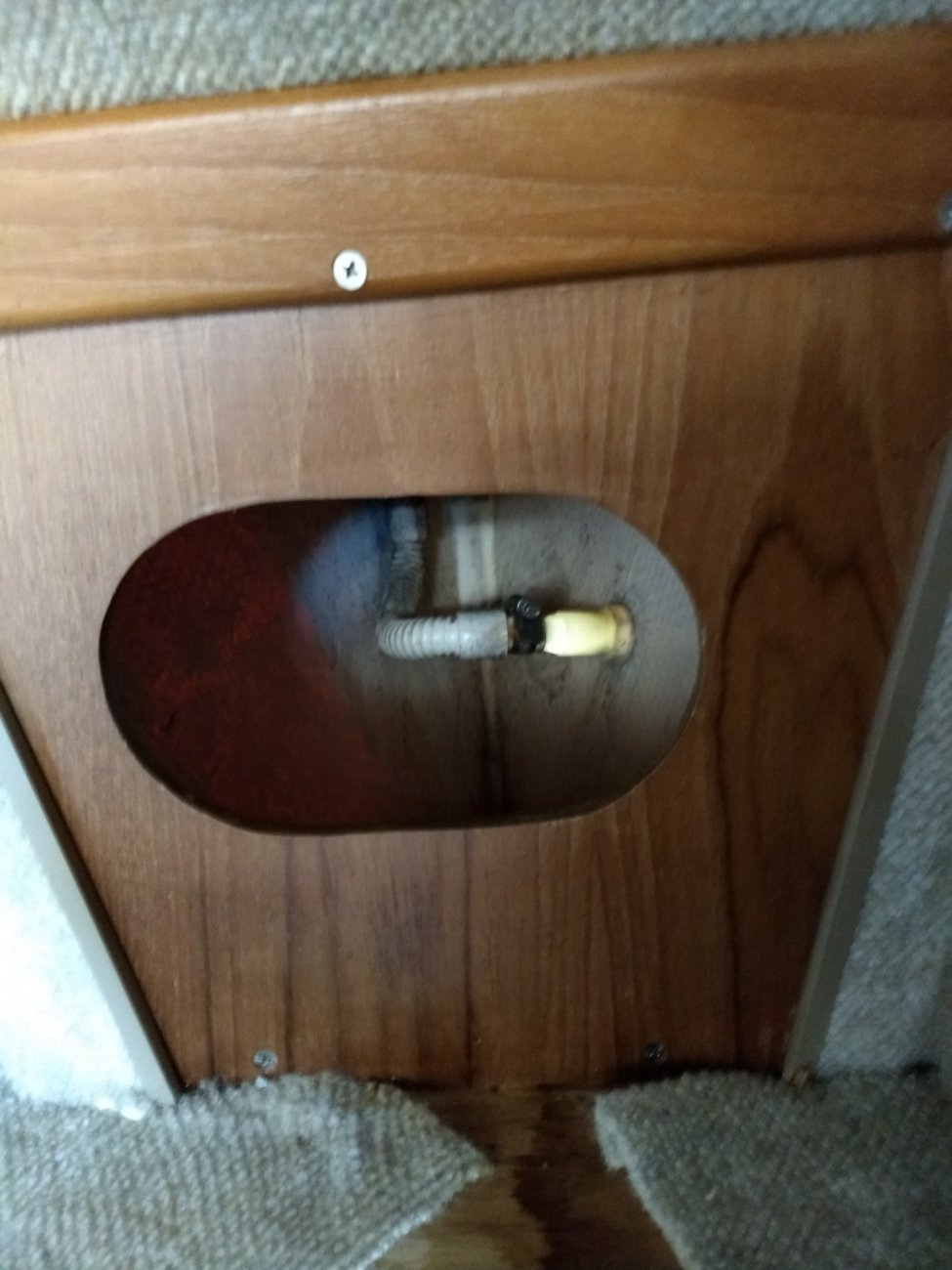

Can you take photos? Not sure what you mean by "assembly of parts". In both cases there is a hose from the scupper down to the thru hull. My boat has a white plastic ribbed hose for the anchor locker, which I assume is original but I don't really know. It is long enough that it loops down below the above water line thru hull and then back up, which I don't like. I do cover the boat so I should not have and have not had freezing/cracking issues. The access panel in the v berth is missing, so easy for me to look at it. Mine has what must be a non standard repair for the cockpit drain as it is rather robust black hose, probably radiator hose, with pounds of silicone glommed around the thru hull fitting. Don't like it, but since no leaks I have left it. Don't get a thin walled hose there, as if stowed equipment pierces it you have a big problem.

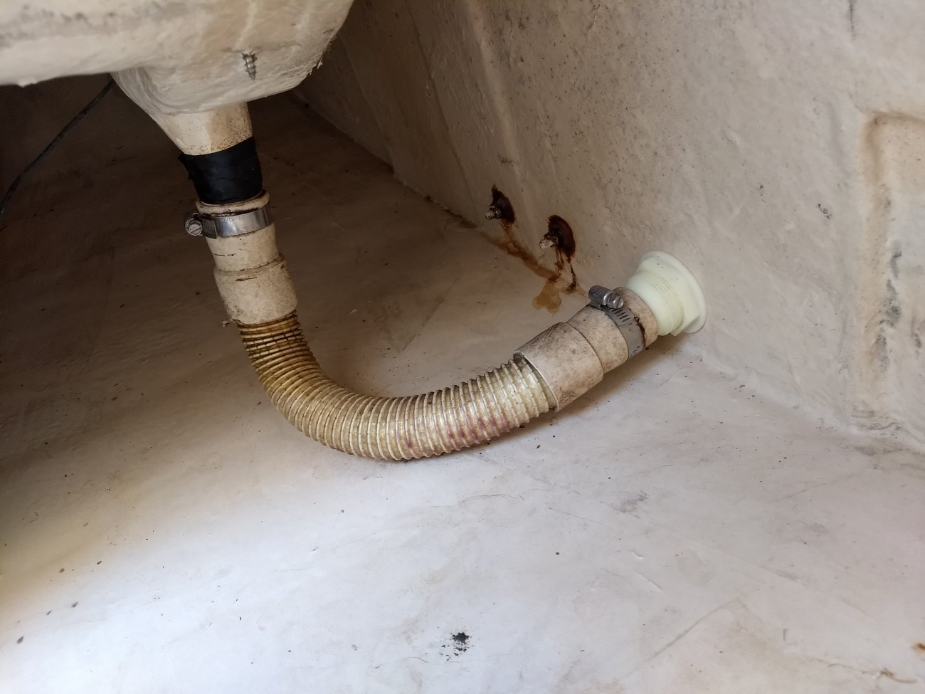

Here are some pictures of the cockpit drain and the anchor cubby drain. The cockpit drain line is a larger diameter tubing and both appear to have "cuffs" on them.
The cuffs and the hose look to me like short lengths of the same kind of hose used for pool vacuum equipment. In a pool setup the cuff can be just rotated off the hose like unthreading a nut. Although the open end is clamped the other isn’t. On a length of hose you have 4 potential joints that might leak. With a “solid” hose you would have only 2. Just saying.....

The anchor locker looks similar to mine, except my hose is longer and droops down more. I have no idea if any of what I have is factory supplied.
The repair job on mine does not use that white hose. I have no idea how secure the hose piece is inside the cuffs. In any case, I would add a second hose clamp to each end of the cockpit drain hose, as you definitely don't want the hose slipping off the fitting.
Is that rust on the nuts visible inside the transom? That is where my swim platform is attached. I'd check that.
