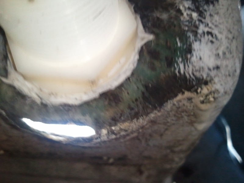

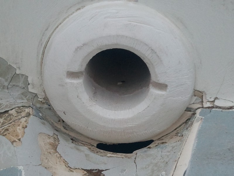

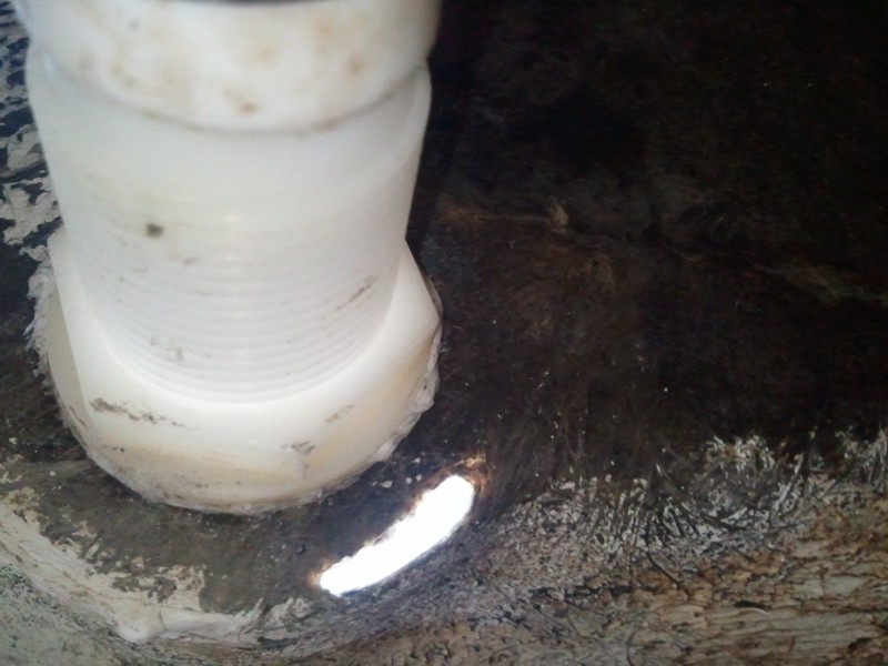

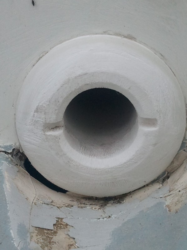

Hello All,
I have a 1974 Hunter 25 that I've been doing some repairs on over the last year. I'm currently working in the cockpit and I notice that there is a small slit under each cockpit drain. I'm not sure it these where intentionally placed there or if they are the result of rot.
I'm guessing that they where put in to drain rain water out of the cockpit since the cockpit drains set above the cockpit sole.
My question is, has anyone heard of drains like these?

I may have misdiagnosed this but if the small slit is in the through-hull fitting itself, it is there for the wrench needed to turn the fitting as the guy on the other side turns the locknut during installation-- no other reason. Most plastic through-hulls have this or else a peg inside to do the same thing with a different sort of tool.
I made the mistake of 'restoring' my 1974 RC Marine (now Forespar) Marelon through-hulls in the back bulkhead of the cockpit rather than replacing the whole thing. They are awful-- not the parts themselves (which actually held up fine, as they resist UV better than do the more common Perko nylon ones-- ugh), but how they were installed-- not even symmetrically placed, sawn-off to provide a flat in the flange to get them closer to the sole, and still not sufficient for all water to drain out. The procedure upon arriving at the boat is to have someone else stand at the transom to coax more of the rainwater aft and then to sponge out what won't go down the drains. The cockpit sole is a constant morass of brine and slime. I removed them, took more off the flanges to enable them to be lower, and rebedded them in a swamp of 5200; but one still leaks a little (I suspect an invisible crack) and they still don't drain well. I also chiseled some of the bulkhead out to make them more symmetrical than they were; but it's far from perfect.
You may also be seeing a gap under the fittings as I noticed mine were not really willing to perfectly meet the cockpit sole itself but sit a little high despite my efforts to remedy that-- probably due to the radius of the molded cockpit not matching the flat of the back of the fitting flange.

Those sure don't look stock, more like that area has rotted out over the years from water accumulation. Does it allow water to drain directly into the bilge? If so, I'd plug them up for sure.

Don, that is not normal.. looks like maybe freeze damage in water saturated glass, or impact damage that cracked those holes around the edges of the thru-hull fitting.. In the right-most picture, I can see a crack extending from the edge of the "slot" around the thru hull .. Kinda looks like a poor lay-up at the factory in New Jersey and too much resin and not enough glass in the area.. ??
