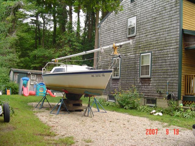

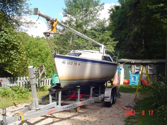

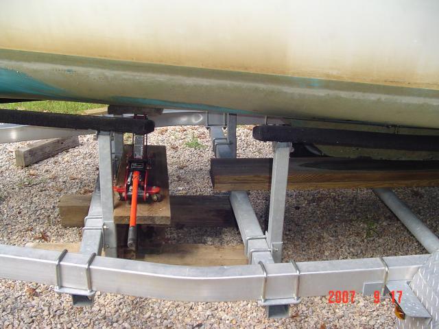

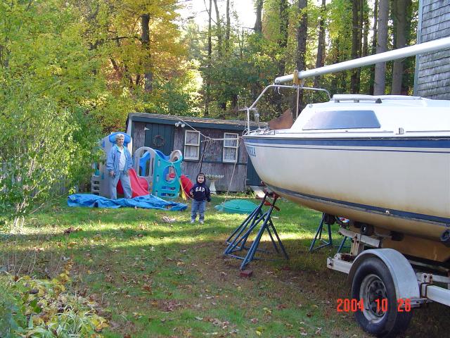

I'm thinking that the previous owner bought a tiller for this rudder that was wider than the original tiller, and in order to get the desired fit in the rudder head, he may have raised the rudder head by lowering the pintles. I did the same thing to my rudder years ago. This would give the desired clearance between the top of the transom and the underside of the tiller, but it would raise the rudder blade to a point where you can't take it off. The only cure for this problem is to buy a tip up rudder. You should be able to un-ship that rudder without having to remove screws. As for the centerboard pendant line, you need to get part of the boat off the trailer to get at it. This task is easier with a roller trailer and two, or even four sailboat stands, some rope tied to the stern of the boat and a tree or something solid. You would need to use the towing vehicle to pull the trailer out from under the boat. The rope tied to a tree keeps the boat in one place. The boat stands placed two on each side of the stern will keep the boat from tipping. I would place blocks under the stern to carry the weight of the boat. It's quite possible to get enough of the boat off the trailer to let the centerboard down and replace the pendant line, but it can be dangerous. The easiest and safest way to do this is to bring it to a boat yard and have them lift it for you or have them do the job. Of course, you'd need the new pendant line with the shackle before hand. Unless you have the equipment at hand and the means to do it at home, it's not an easy task. If your trailer is a bunk trailer, You would have to jack up the boat from the ground and move the trailer ahead little by little until the centerboard can be dropped. If you decide to do this yourself, have someone help you and do it as safely as you can.

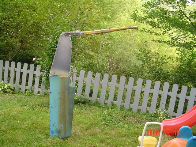

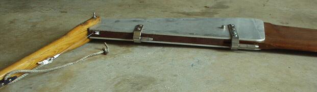

Thanks for the pictures.
1. Did you make a kick-up rudder from a one piece original?
2. How far down does the centerboard have to drop from the keel to replace the control line to the centerboard?
I appreciate the help!
Jan 24, 2005
4,881
Oday 222 Dighton, Ma.

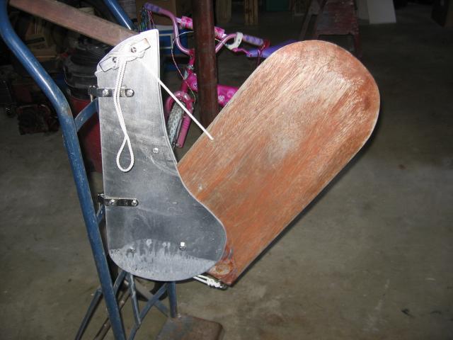

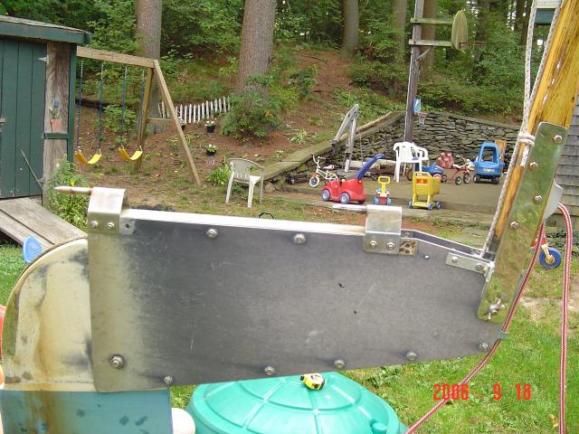

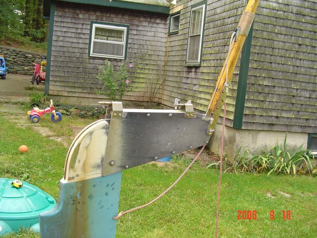

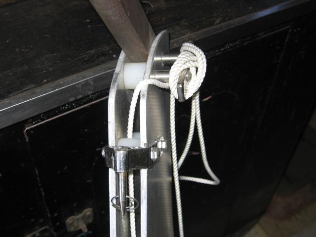

My kick up rudder came stock with my 86 O'Day 222, but that doesn't mean that you can't make one for your boat. The original rudders that came with some of the O'Days were made by molding two halves. Then they were glued together, and pumped with foam. I think that the rudders were manufactured by a company in Clearwater Fl. They may have built these rudder blades this way to keep the weight down to a minimum, but these blades had a tendency to break after a while. I went through two of them before I smartened up and bought one through D&R Marine in Assonet Ma. One of my friends built a tip up rudder for his Bayliner Buccaneer, and it came out pretty good. The O'Day tip up rudders came with a pendant line to hold it in the down position via a 1/4" braid pendant line and a self rescue clam cleat mounted under the tiller. I added an extra pendant line to my rudder to hold the blade in the up position, and I used a fair lead and a self rescue clam cleat on the top of my tiller. My friend liked this feature, so he adopted this idea when he built his rudder.
My centerboard is about 12" wide, so you may need at least about 18" of clearance under the keel or less, to get at the pendant line shackle. You could always dig a hole under the keel to get more access to the board if you had to.

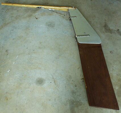

I like the photos of the rudders. The wood one must be your buddy's and the fiberglass one from your O'Day.--- Mine looks like your fiberglass one and it measures down 32" from the waterline so I,m thinking of making it into a kick-up type as yours. Do you have any plans for the one you have?
I suppose it would be easy enough to make by sight. Is the outside housing stainless steel on both sides or aluminium?
I have had 3 boats with this type set-up and they work great.

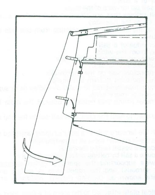

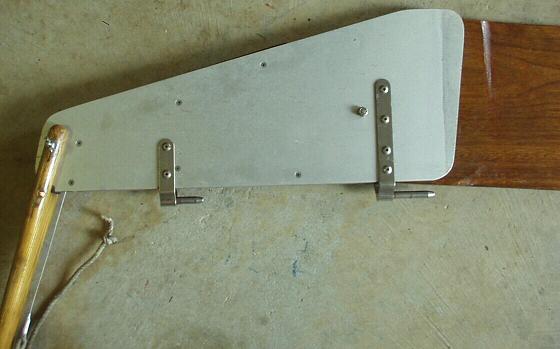

The original fiberglass rudder for the O'Day 20 did not extend under the stern as far as I can tell, so your rudder may not be original. The O'Day 23 (1977-85) and the 25/26 did have rudders that extended underthe stern. To remove these rudders one needs to pivot the rudder to one side or the other until the rudder clears.
O'Day did offer a kick-up rudder as an option on the 20, I'll post a picture of one of these. If you can find a source for the materials it might be a good Winter project to build one.

I thinking of cutting the one that came with the boat and scab aluminium sheets on both sides and a stainless steel bolt for it to swivel on. Do you have any dimensions for the kick-up rudder that you posted?

I am interesting in knowing how thick of the aluminium sheets would need to be as i would like to build one due to my shallow mooring area?
i will try to measure my oday 20 stock rudder for you (not a kick up) and post these.
also, look at the "questions fromr a green horn" posting. joe has a link for building a rudder from marine plywood which may be of help.

I thought that the O'Day 20 came through with a kick-up rudder, which would make sense so the 14 draft would be effective and you could sail very close to the beach or in a shallow area.
I plan on changing it to a kick-up on mine one way or another.
Let me know how you doing on yours.

O'Day 20 rudder dimensions

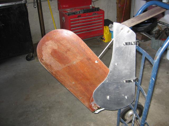

I don't have the dimensions, the pictures came from someone with a 20 who posted them on one of these message boards. It looks to me that the basic outline of the kick-up rudder matches the original one-piece fiberglass rudder, so maybe a fellow O'Day 20 owner could measure/trace their rudder for you. Making a kick-up rudder from the original fiberglass one is not impossible...but it might be easier to make the new one using marine plywood with aluminum cheek pieces (those are the plates on each side of the pictured rudder). I have made kick-up rudders for a couple of small sailing dinghies using the original one-piece rudders as a template. If you could get a chance to see a disassembled kick-up rudder (any size) it will help you to design your own. I found it to be an interesting project and for my boats it was definitely less cost than buying a commercially made rudder.
One other option would be to buy a new kick-up rudder from www.IdaSailor.com They might have a better price than some others, although their kick-up rudders look alot less beefy than the one I posted pictures of.
