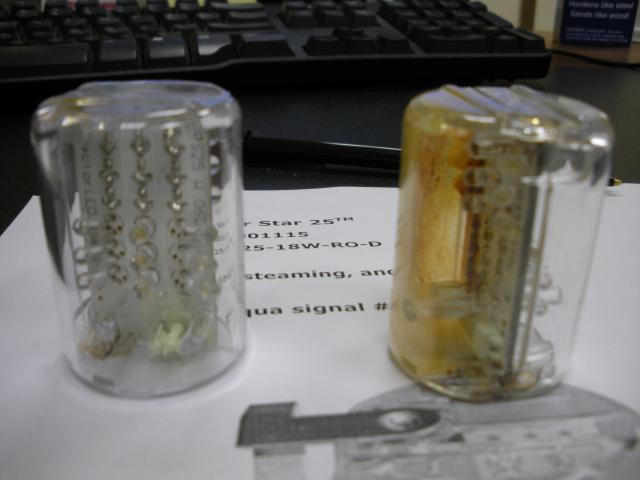

Has anyone installed the Dr LED's Polar Star 25 in their boat? How are they working for you?
I did last season and had 2 bulb's go bad on me. One bulb developed rust inside. Not sure how that happened because the bulb is supposed to be sealed and it was inside a fixture. Only four of the twelve internal LED's are working on the second one. I barely used them last season. Over the phone Dr LED said they would give me half off new ones and to return them. I returned them 5 weeks ago and have sent a few emails and I'm not getting any response. This has been a frustrating experience.

Have you checked the voltage feeding these?
I doubt you'd end up with a voltage high enough to smoke these but that appears to be smoke residue not rust. A sign of a catastrophic failure of the mod circuit. Over-voltage could do that and cause failure of both.

Rob, I could do that but I think this happened over the winter. The mast is stepped and stored on saw horses in my yard. I'm waiting to see what Dr. LED says, That is if he ever responds. They have the bulbs.

I have one in my steaming light, and it did the same thing. My mast is stepped for the winter, and when I was covering the boat for the winter thought the light looked "funny". Took it apart, and the Dr. LED was FULL of water. I shook it out like a salt shaker, and dried it out. I was coated in a rust residue. When I was sure it was dry I tried it out and all LEDs worked. Last fall, same thing. Stepped the mast, and didn't get the bulb out right away and had water again. Not as much, but still wet. All LEDs still work, but the thing acts like a sponge. Not exactly what I expected from a bulb meant to be in a marine environment and the cost.
