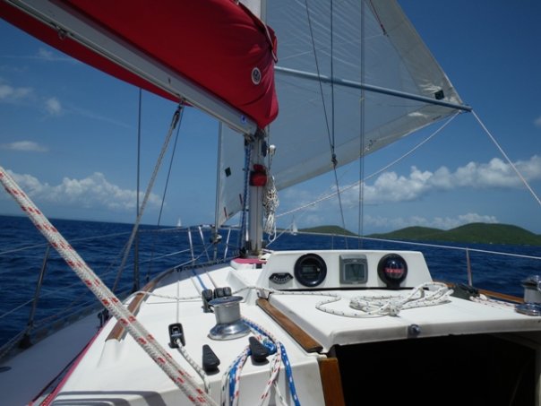

Wing to Wing
Hi;
We have a Beneteau 32, we sail a lot DDW and usually goes very well,
Here are a few tips:
Main Sail:
· Don’t be afraid if the sail is touching the spreader
· Loose your halyard
· Loose your Outhaul
· Tension first your topping lift and then your boom vang
Genoa: (with a pole)
- If light wind, loose your halyard
- Take your sheets out of your genoa cars and place a snap block on your rail at the widest part of your boat
- Watch for wind shift, you don’t necessary need to have your genoa with pole perpendicular to your boat, loose your genoa sheet if needed to have your pole like a little forward.
Also remember always put your pole to the side the wind is shifting.
