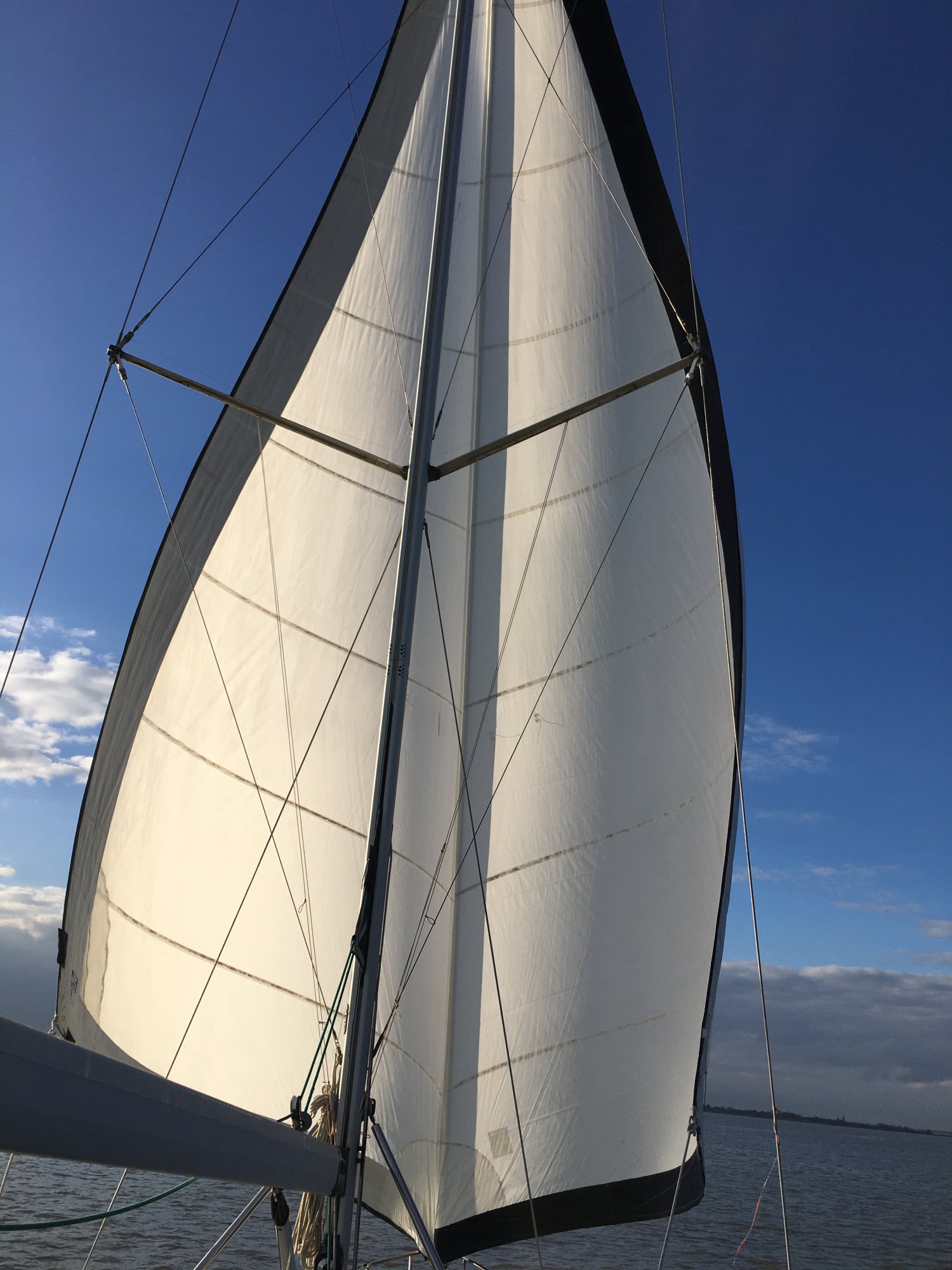

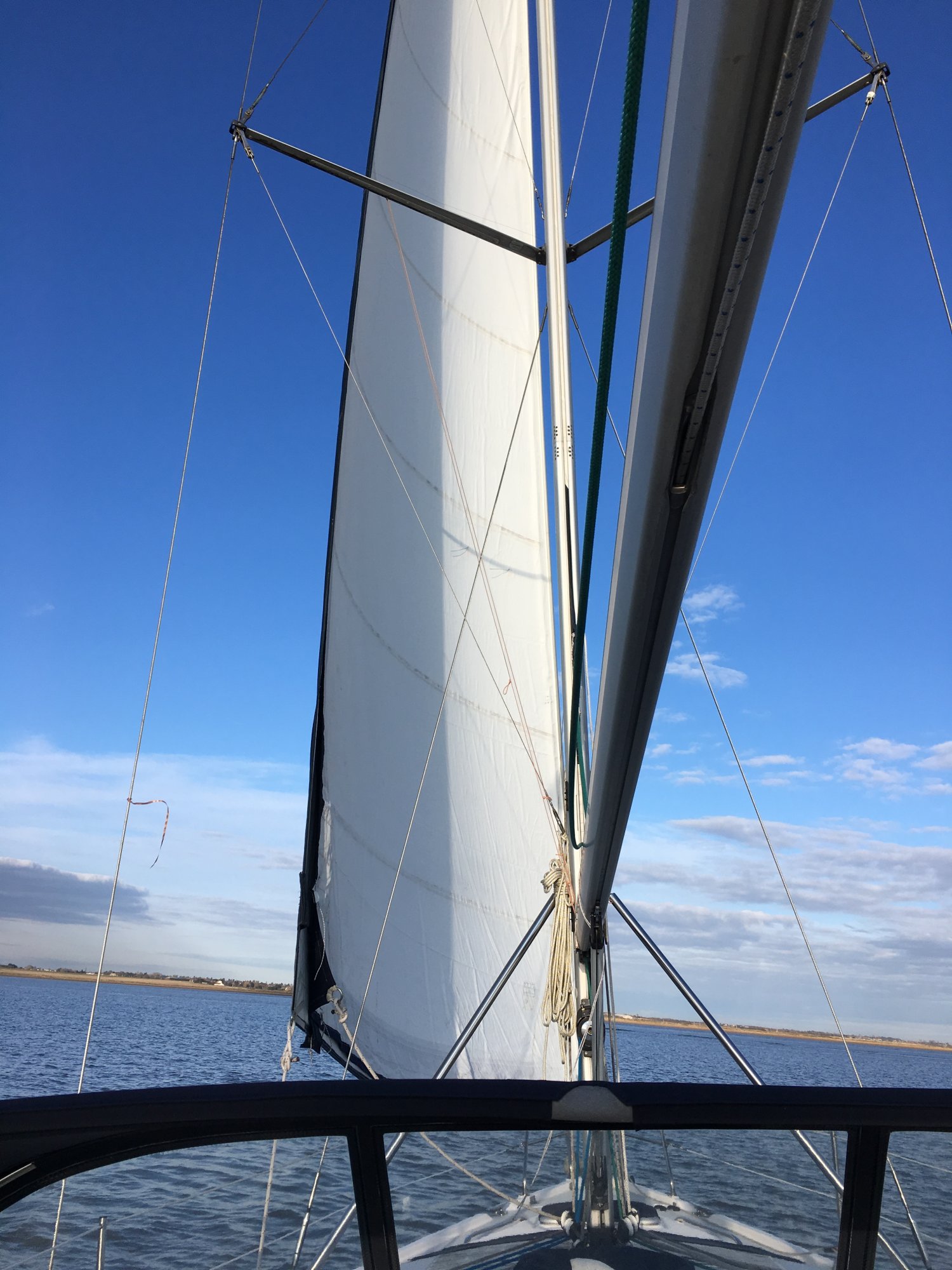

Anyone heard of the Twizzle Rig? (A google search will bring up loads of info') I had often thought that two Jibs on the same furler would be a great idea, so researched it. It turns out that someone had already thought of it.
I purchased a second hand Jib that was about the same vintage as our original, which I had to sew to the leading edge of the original as my furler didn't have a double slot for the bolt rope. The two jibs have a sheet each. When sailing into wind they work just the same as a single Jib, the redundant Jib lays against the working Jib. When sailing down wind the two Jibs open out (makes me smile every time!). I recently picked up a second hand spinnaker pole which allows me to continue to use them with the wind up to 30 deg off of the stern. The difference is astounding, and if the wind starts to pick up you can just furl away as much as you want. I have not found the need for the complicated double pole affair that is shown on the videos, and only use the pole if the wind is not exactly aft. Clearly the double pole will make the rig more efficient, but I don't often get the opportunity to sail for extended periods downwind as most of my sailing is coastal short hops.
The padeye I manufactured myself from stainless so can't offer a supplier.
7,936
How do you handle the sheets? I assume that while sailing upwind the redundant sail's sheet has to be trimmed on the leeward side too. Maybe it can be routed to the secondary winch thru a block - where? Or is that what the padeye is for? Do you use this configuration sailing ddw with the main up? Doesn't the main kill one of the jibs?
Jul 1, 2017
64
Hunter 356 Brightlingsea
Sailing upwind is just the same, even though you have a single sheet on each sail. The windward sheet is just left slack. The clew of the redundant sail will sometimes "show" a little, it depends on the friction in your system.
I will sometimes have the main out tight and slightly windward to help guide the wind into the split Jibs if the wind is really light and I am trying to "gather" as much wind as I can. Typically downwind in 8kts with one Jib I will make 3kts, with both 4kts plus.
